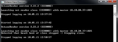

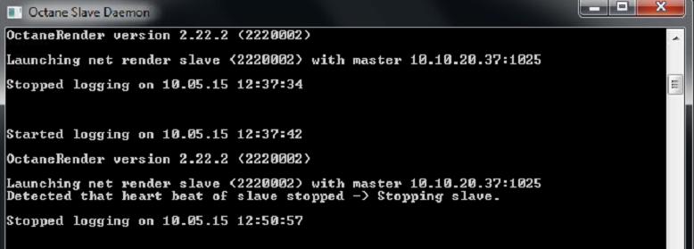

miohn wrote:Hmmm,
unfortunately, now comes the disillusionment.
Slave GPUs are listed correctly and running, but they don't start to render.
A 7000px image needs about 1 hour 20min to render on my Master with 2 Titans.
So I thought another Titan-Z would be helpful. But...
For 26 minutes the Slave-Status is on "updating" and in MInute 27 the Slave stopped working.
"Detecting that heart beat of slave stopped ..."
For animation when a frame renders about 2 or 3 minutes, the slave never gets a
chance to start rendering.
So it seams, that Network-Rendering does not make much sense in my case, because the
upload/updating times are way to long.
But anyway! Thanks much for your support!
Mike

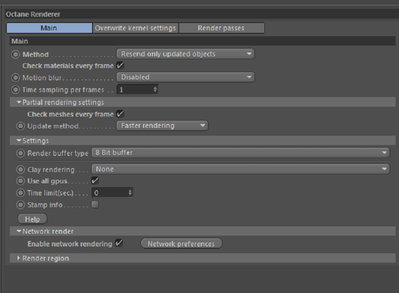

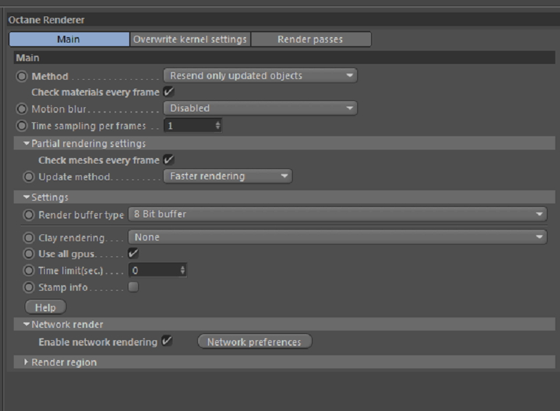

This scene is set to 'resend only updated objects':-
If a frame is taking 48 seconds to render locally, wouldn't you expect fairly close to half that time with twice the render power? Certainly to take twice as long with twice the render power would be a big problem! The difference between a render time of 0m30s and 1m30s per frame is just massive for the amount of rendering we do.

Hi Abstrax,

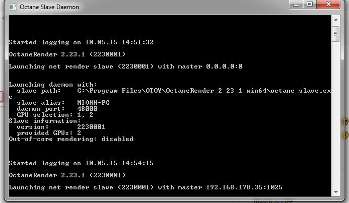

Master: Win 7 64, R16, Plug: 2.23.1 R4, Standalone: 2.23.1, 64GigRam, Dual Xeon 2680, 2 Titan
Slave: same Software/Versions, 16 GigRam, 2600K, GTX560 and Titan-Z
Connected via Fritzbox Cable 6360 all Ports/Switches at max. Speed

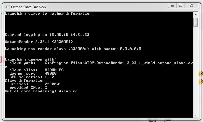

I'm starting "run_installed_deamon-bat" on the Slave.
Seams o.k. for me so far.

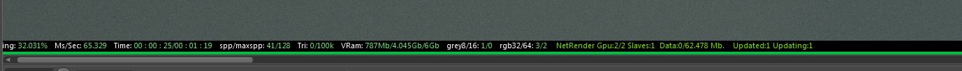

Then on Master Plugin I enable network rendering and activate the Slave Gpus
Status says: updating (even on a simple scene)
But Slave never renders.
After a while Slave stoppes.
thanks
Mike

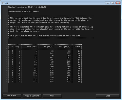

abstrax
Posts: 5516
Ok, thanks for the info. To figure out, if a network connection can be established and how fast it is, we added a command line argument to Octane Standalone to run a network speed test. Unfortunately that's currently broken in 2.23.2, but here you can download a Windows version that is fixed:
http://render.otoy.com/rcdownloads/Octa ... _win64.zip
After you have downloaded the archive, please extract it on your master and your slave computer. The archive contains two batch files _run_net_test_master.bat and _run_net_test_slave.bat.

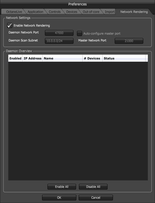

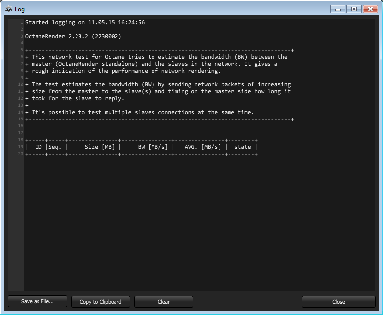

To run the Standalone in the network test mode, just run _run_net_test_master.bat on the master computer and open the log window, which should say something like this:

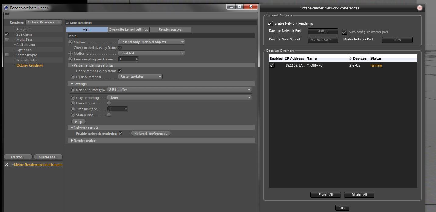

Make sure that network rendering is enabled and the master port is set to 21000:
To run the slave in network test mode, you have to edit _run_net_test_slave.bat on the slave computer in an editor of your choice. The file contains this after unpacking from the archive
Code: Select all
@set MASTER_IP=127.0.0.1
@set MASTER_PORT=21000
octane_slave -a %MASTER_IP% -p %MASTER_PORT% --net-test
pause

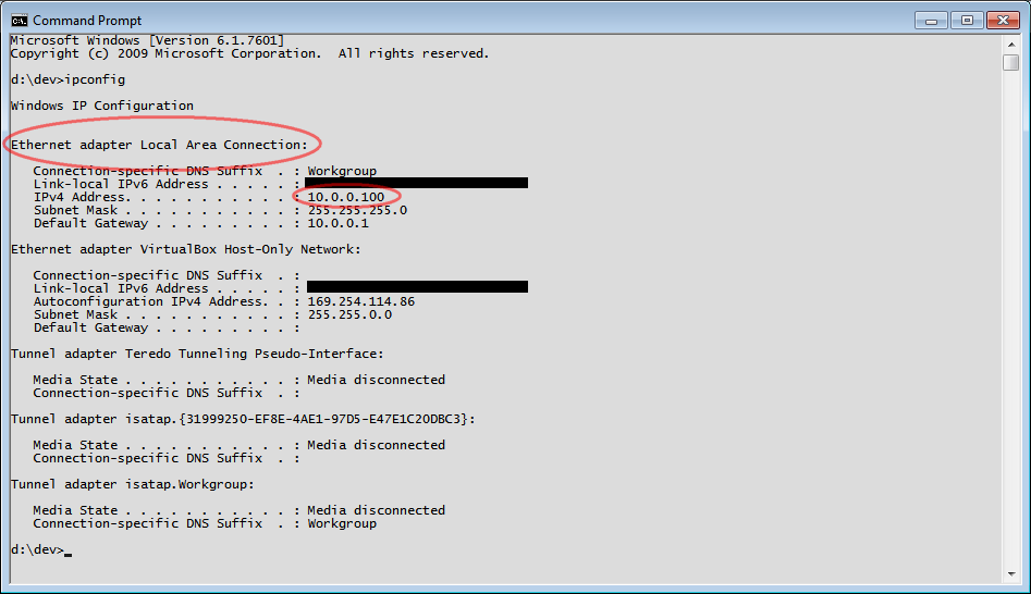

You will have to set the variable MASTER_IP to the IP address of your master computer, which you can find out by running ipconfig on the command prompt on the master computer:
In my case for example, I would change _run_net_test_slave.bat on the slave computer to:
Code: Select all
@set MASTER_IP=10.0.0.100
After you have done this, you can run the slave in network test mode by executing _run_net_test_slave.bat on the slave computer.

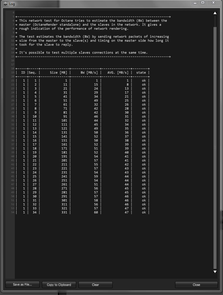

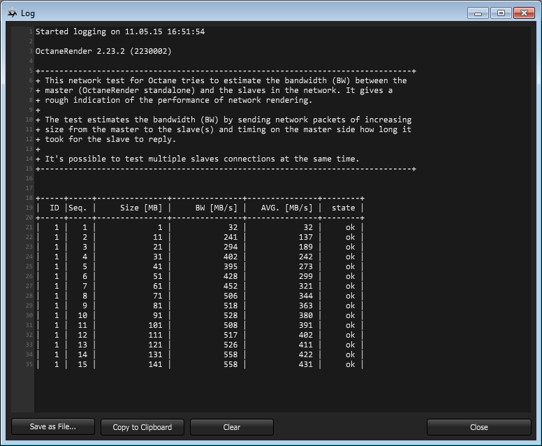

After slave and master have connected, you should see in the master log the speeds we achieve for sending packages of increasing sizes:
So, could you please run the above and let me know, which speeds you get? Thank you.

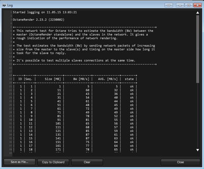

Iksmada
Posts: 18
Joined: Sat Mar 30, 2013 11:43 pm

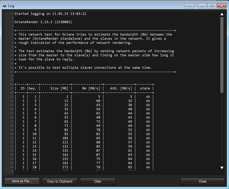

miohn
Posts: 783
Joined: Sun Jun 06, 2010 3:00 pm
Hi Abstrax,
heres the result.
Seams that you're right. My speed is way to slow compared
to yours and implied that I did the test correct.
So question is: what could causes my slow network connection?
What should I try or change?
thanks
Mike
Iksmada
Posts: 18
Hi Abstrax,
Looks like you were spot on - my results are also much slower than yours:-
Please can I ask you what speed your connection is? Do you think we will only get the full benefit of network rendering in Octane when using a 10GbE connection, especially with complex scenes?
