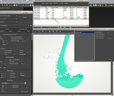

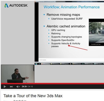

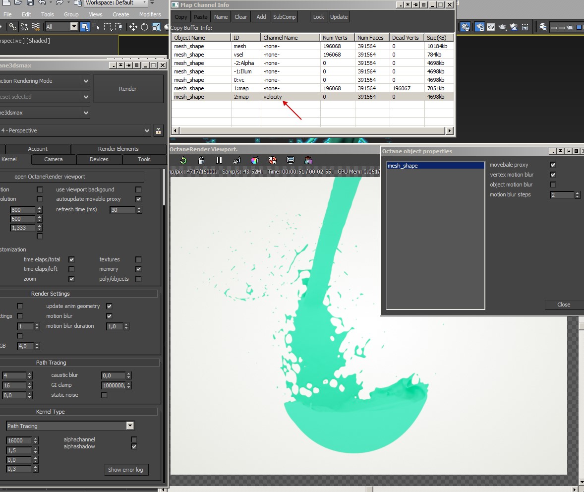

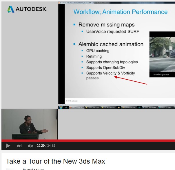

abstrax wrote: As I said in the 2.21 release thread, if the Alembic file has vertex speeds, it renders it. As far as I know (and I don't know much about the 3ds max API), there is no way to fetch vertex speeds from a 3ds max mesh. Dmitry will have a look at it, when he's got some time available
abstrax, in 3ds max 2016 there is support for velocity channel in alembic file!!! hope can quickly fix motion blur, when you'll do a plug-in for 3ds max 2016. :)
