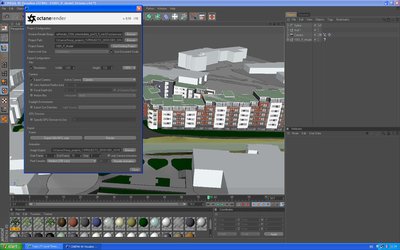

Here's a screenshot of the exporter window:
Posts: 10643
is your c4d project on a network disk?
I save the scene from my mac to the pc with the "save project" command and than open the scene on the pc, change the path, start octane and all works.
hope it help ;)
ciao beppe

The project was saved on a server so I tried what you suggested and got a bit further.
I now have another problem. When I click "render animation", Octane launches and starts loading and voxelizing the mesh but then I get an "Automation Error" message. It says something like "meshnode for rendering "1001_P_Model.obj" not useable". I had a look around the forum and tried some other people's suggestions but have had no luck. It renders fine when I export just the obj and render stills straight from Octane.
Any suggestions...
Thanks,
Rico
face
Posts: 3204
Location: Germany
Sounds that the exported mesh and the mesh in the Octane ocs-file are not the same.
