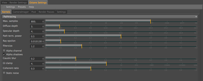

Ok, i've figured out the haze a little. Now i'm just trying to render out a movie of this to see how things are working. Right now, i'm noticing my star texture and the reflection of my water is flickering a lot and I'm not sure where that's coming from. I'm using Pathtracing. Here are my settings:
