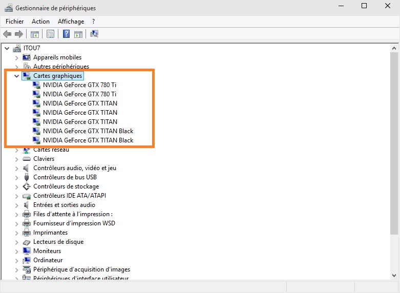

Final intégration of my eGPU system :
- external tower with 900W and autonomus watercooling.
- Amfeltec 4x to 4 PCIe 1X
- 2 Titan Black + 2 780Ti
- Watercooled : Delta T° at full load +13°C (20° ambient)
- 1x PCIe riser (50cm USB 3) available for the 5th GPU on the external tower.
- powering 2 titan black by the main tower (1600W already powering 3 titan + i7 3930K), the 780ti are powered by the external tower 900W (have enough room for another 780Ti).
- the synchronisation of two power supply is done by the motherboard (green wire), and not with a relai.
- consumption of the whole systeme on octanebench : 1450W on primary.

update for power consumption : I just measure the input power of the whole 2 rig :
- at standby (idle windows) : 260W
- at full octanebench : 1620W (up to 1700W peak)
- playing world of tanks : 550W (only 1 titan)

itou31 wrote: update for power consumption : I just measure the input power of the whole 2 rig :
- at full octanebench : 1620W (up to 1700W peak)...
Thanx for sharing.
Do I understand correctly and the number is for 2x780Ti, 3 Titans and 2 Titan Blacks?
And all on watercooling?
Nice rigs, man!
Thanx for sharing.
Nice rigs, man!
Yes, that's right number and all watercooled. I'm searching for one more titan or 780ti as I have one more room and pci 1x ready. After then I don't know if it is possible to have more than 8 GPUs (in windows 10). I just need perhaps to powered the all external GPU (2 titan black and 2 780ti) with only one power supply that I can disactivate if not use for octane (when I play games for exemple).
