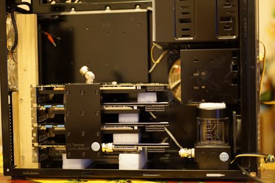

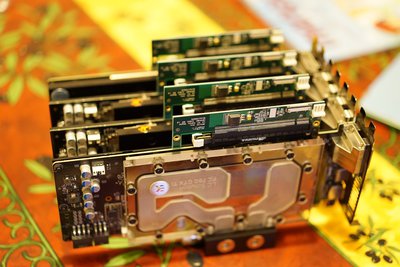

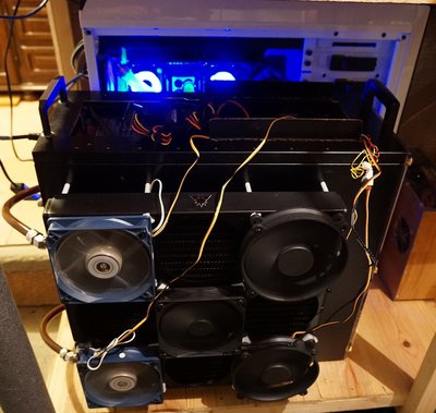

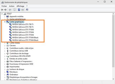

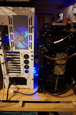

Final intégration of my eGPU system :
- external tower with 900W and autonomus watercooling.
- Amfeltec 4x to 4 PCIe 1X
- 2 Titan Black + 2 780Ti
- Watercooled : Delta T° at full load +13°C (20° ambient)
- 1x PCIe riser (50cm USB 3) available for the 5th GPU on the external tower.
- powering 2 titan black by the main tower (1600W already powering 3 titan + i7 3930K), the 780ti are powered by the external tower 900W (have enough room for another 780Ti).
- the synchronisation of two power supply is done by the motherboard (green wire), and not with a relai.
- consumption of the whole systeme on octanebench : 1450W on primary.

update for power consumption : I just measure the input power of the whole 2 rig :
- at standby (idle windows) : 260W
- at full octanebench : 1620W (up to 1700W peak)
