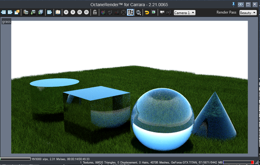

Also, replicated grass on infinate plane, see image below....
Replicated grass on infinate plane.

orion_uk wrote:Re: OctaneRender for Carrara 2.21.0067 [Test]...Well LRVP still says 2.21.0065 after installing?
Oops, my bad...
orion_uk wrote: Also, replicated grass on infinite plane, see image below....
Sorry, not supported. You would likely run out of memory anyway since each copy of the plane would have to be added to its own scatter. I'm not sure how many blades of grass you have replicated but imagine multiplying that by 40000.

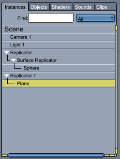

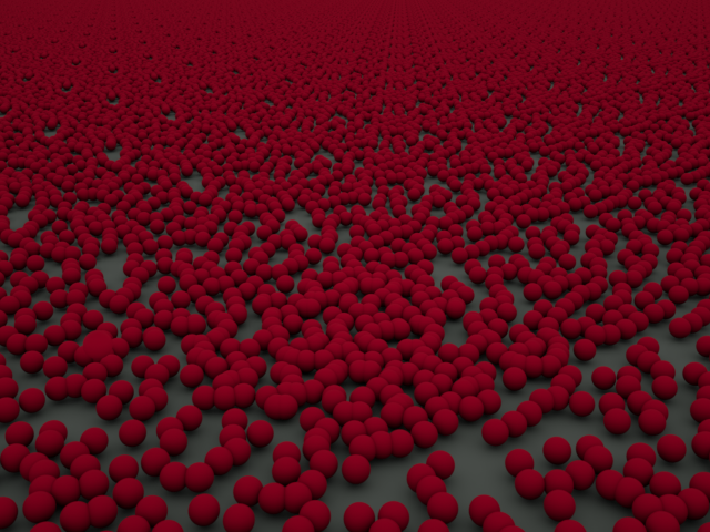

You can also simulate an infinite plane using a replicator with a grid pattern. I used a replicator and a plane for the base and I used a Replicator a Surface Replicator and a Sphere as my scattered object. This is the result:
Scatter Configuration
Scatter Plane
Scatter Plane
