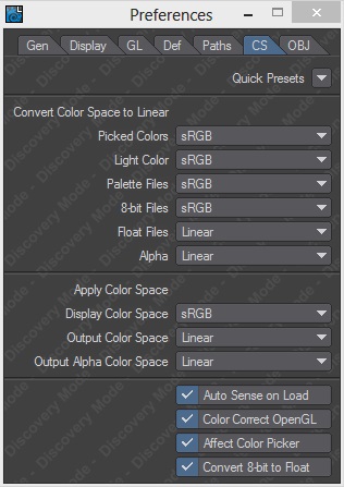

The problem was that the scene had the LW color space functions enabled, specially one very dangerous: the "Convert 8-bit to Float" option, as you can see in the attached image.
With the "Convert 8-bit to Float" option enabled, when you press F9/F10 the Layout loads all the texture image maps, converts all to floating point images and color correct them. The floating image maps are going to eat a lot of CPU memory. All this information is not used at all in Octane, but Layout stores the corrected maps in memory even after finish the rendering, and this is the problem.
As you know Octane doesn't use the LightWave color space functions at all, you get wrong color corrected images in the IPR, and as you can see you can have a lot of problems with them enabled. To work with Octane you should disable all the LW color space functions.
-Juanjo
