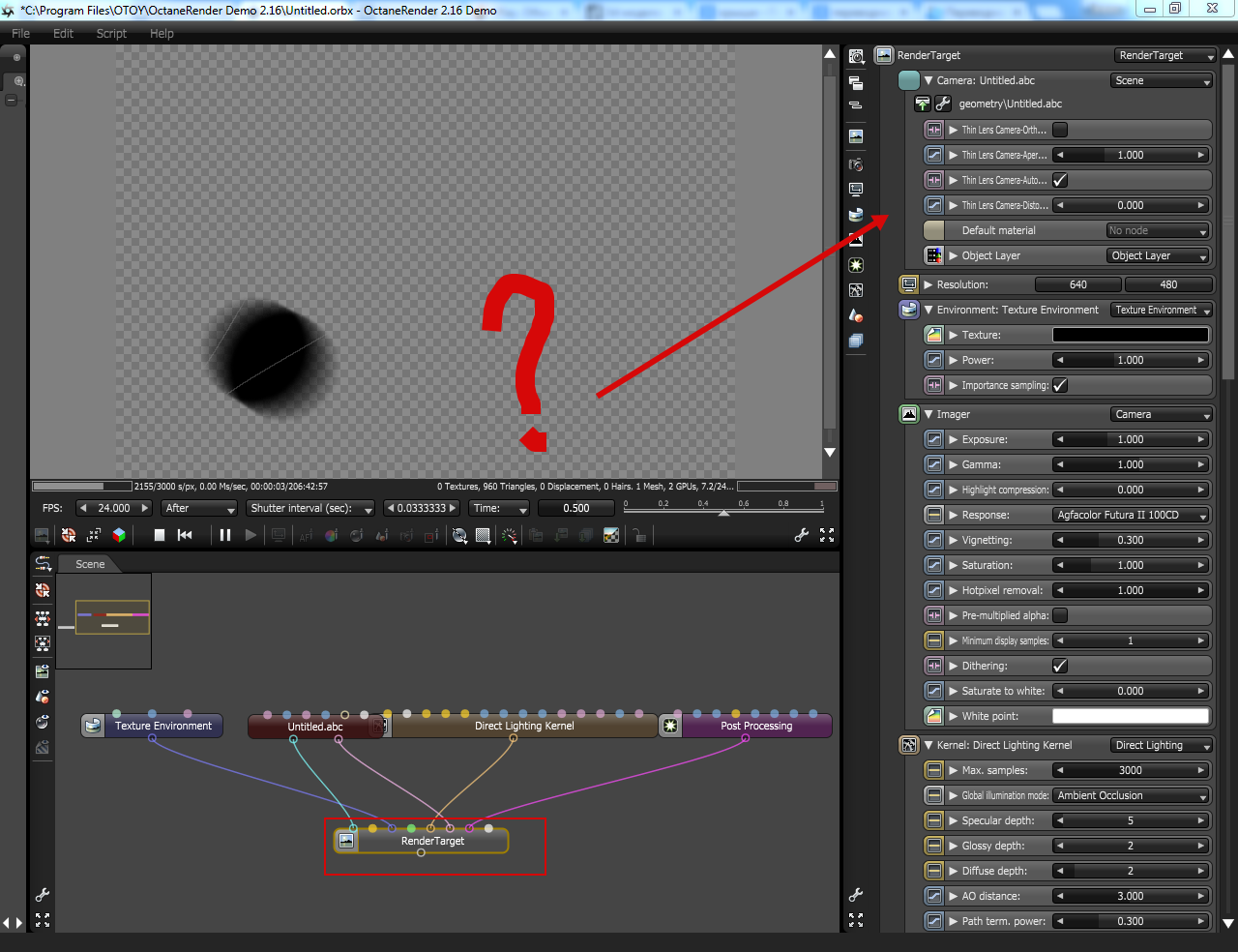

where the aperture? how to set up the animation alembik
