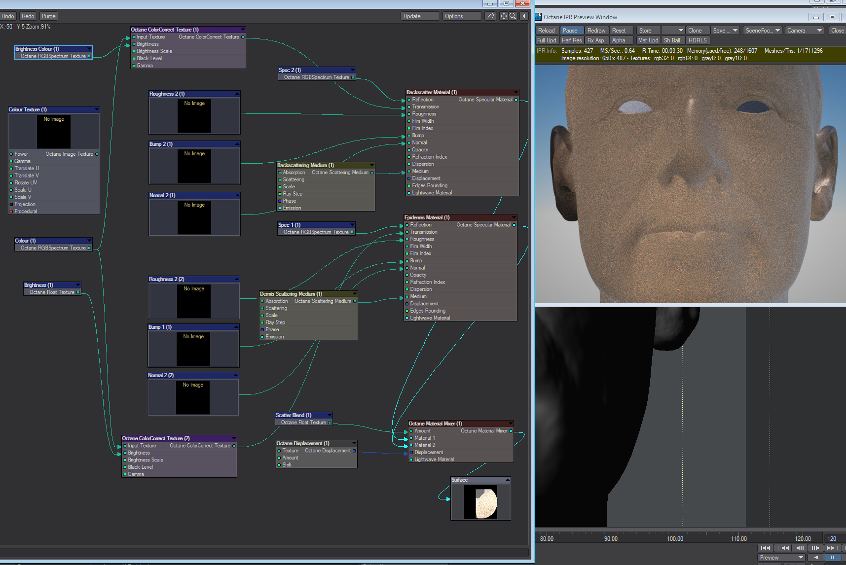

I've attempted to transcribe the TonySculptor Skin R20 but as you can see it's a miserable failure. I don't know whether this just because I don't really understand how the various parameters function, which I don't, or whether, as Juanjo said in the LW thread related to this, there are a few areas that will be difficult to transcribe anyway. I've spent ages on this and am badly in need of some guidance please. I've attached the NOD file with the same values as the original, though some are a guess due to the different unit types used. Does anyone have a working NOD preset that would get me going please?
