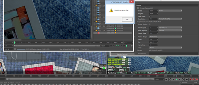

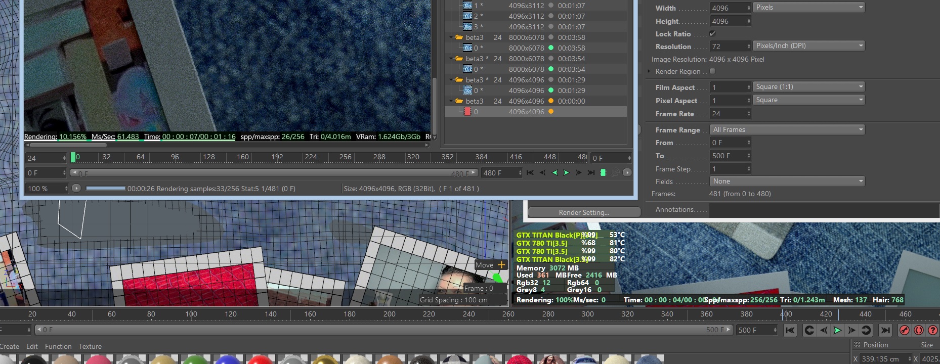

Ok, so 4k did work, but I went to try it again after 8k and it failed again.
Here is a screen grab of the frame rendering...
And here is the error message. As I say, 4k worked a moment ago before I tried 8k :-/

ten,
what's the save format and render buffer type? Btw, what's your fonts on c4d? I see your onscreen info is messed. Doesn't fit to graphic elements

Ahhh.... im so dumb, output format was to .mov just for test animation renders. Of course .mov probably does not support those resolutions lol...
Sorry for wasting your time, Ahmet and thanks for the help :oops:
Regarding the font, Its the standard c4d font but I had to increase size as I have a 4k monitor which makes the gui words almost impossible to read. Would be cool if octane scaled its font with this?? :D
