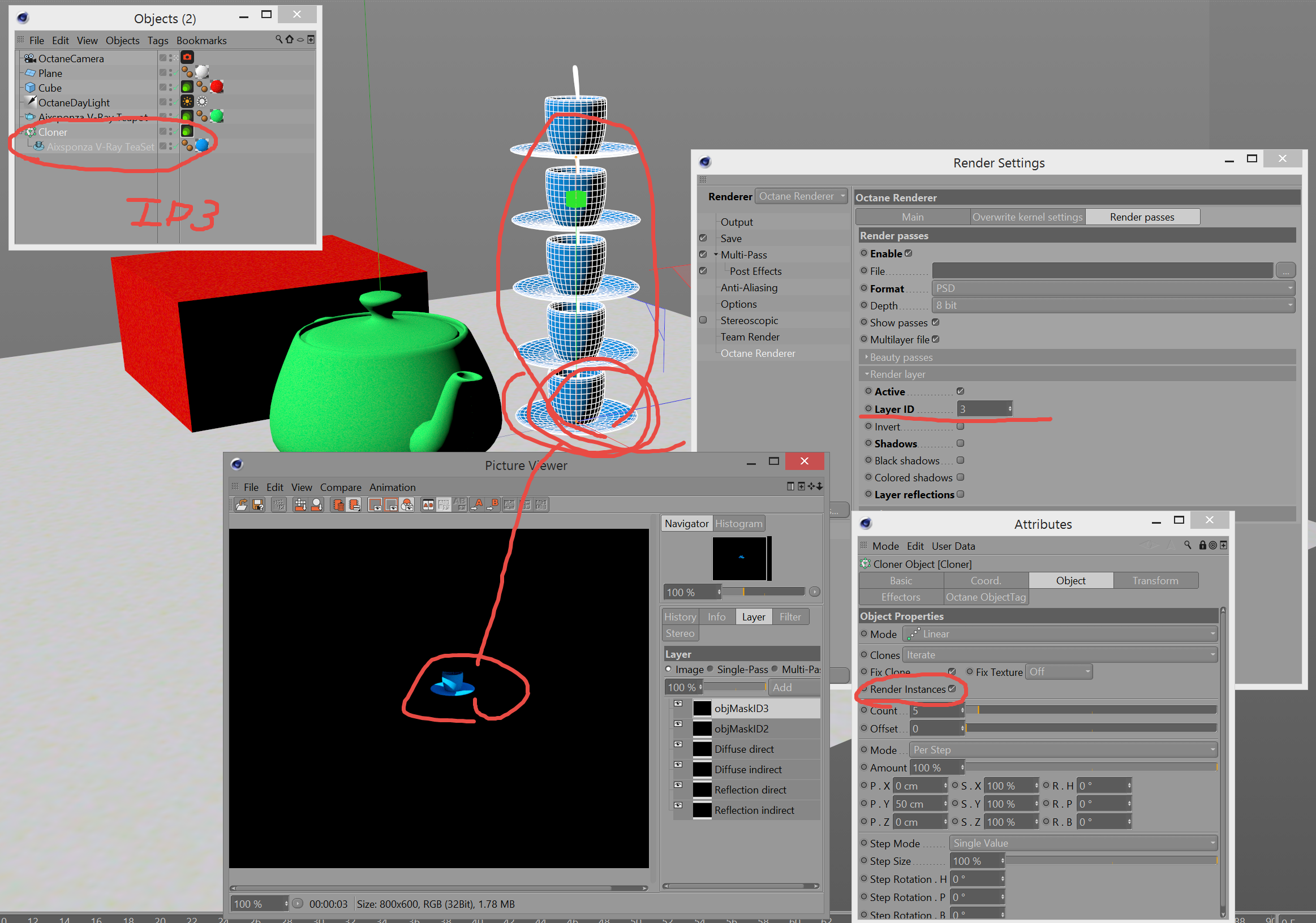

numbering is very strange on octane side. 1=all objects, you should set your layered objects as 2,3,4, etc..eyeonestudio wrote:I Make Two Layer. See...
Render Setting : Set ID Layer 1 : Both Teapot Rendered.
Render Setting : Set ID Layer 2 : Picture Viewer is Black.
It is Normal?
In Live Viewer is OK. Working Good.
Picture Viewer is Not (Render Layer. Layer Mask)
This is RC1. Having Some Bug.![]()

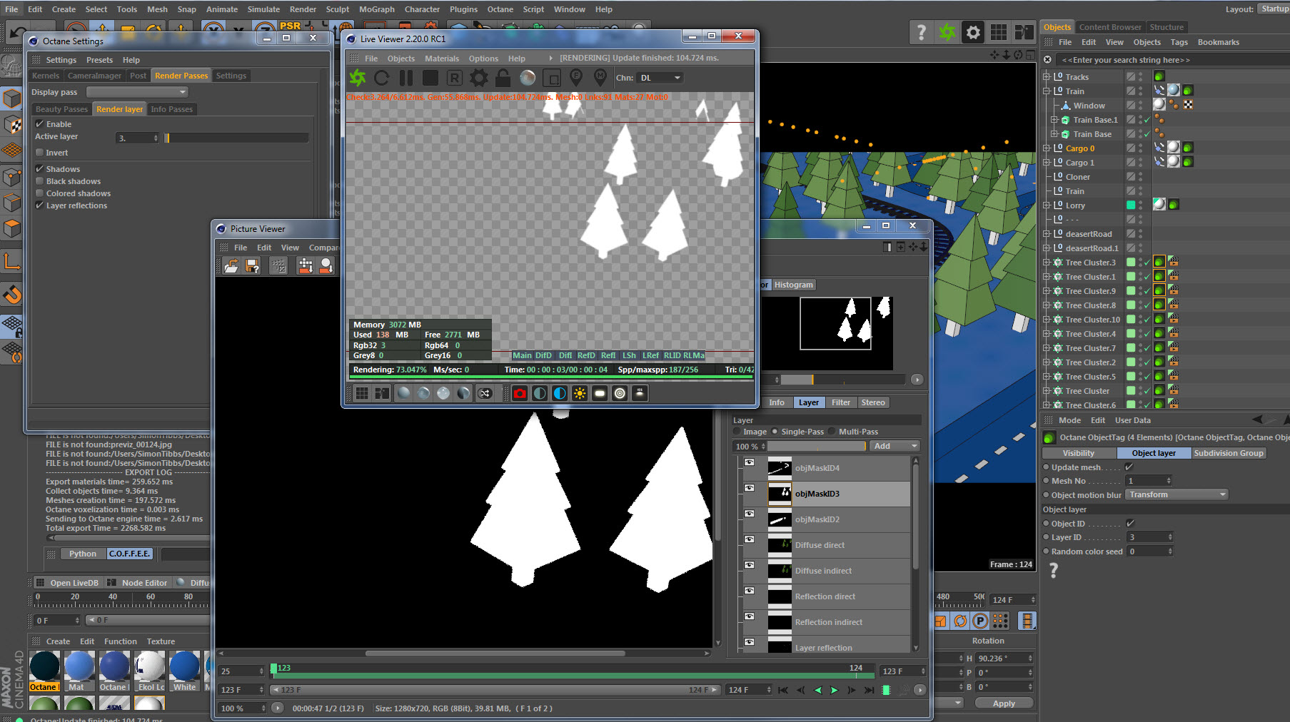

Hi eyeonestudio and guys,
please see this scene. I attached three different layer set to seperate these objects: train, rail and trees which are numbered as 2,3,4. You can see and render one set on one render session for getting shadows and reflections. Also it can produce masks for three sets on same session.Check animation render output.

I found Check point....
(X) Render Setting : Method : Send All Scene Data : Render Layer + Layer Mask --> Not Working
(O) Render Setting : Method : Resend only updated objects : Render Layer + Layer Mask ---> Working
And Other Problem is "Render Instance" With "Render Layer"
(Check Your Scene. All Tree is ID3. But Some Tree is gone)

For first sentence, read this message: http://render.otoy.com/forum/viewtopic.php?f=30&t=44446eyeonestudio wrote:I found Check point....![]()
I explained the structure. You should know that plugin how works. What happens in background...
We need a scatter node for motion blur, instancing, transforms, partial updates, texture projections, etc... This can be provided by object tag.
Also need a object layermap for visibility, layerid, etc... This is also another job of object tag.
scatter and layermap nodes are clue on Octane side. First render method does not support neither of them. Second method works as in Live viewer.
So why i'm keeping first method here? It's good for render speed and camera animations on static scenes.
Regarding to render instances, you're right. I forget to add layerid's for instances. I'll fix it on next version. Thanks
