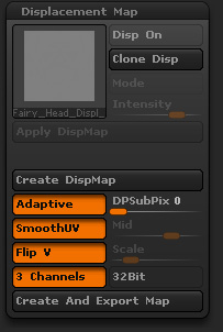

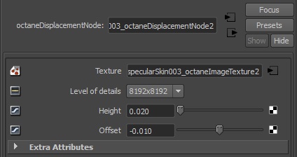

export setting from zBrush. tif 16 bit worked best foer me.

Looks great, cheers.
However, there's a very small negative offset, so I wouldn't expect many issues.
Why is it?

I don't know why, but it appears that the offset with negative setting are causing issues with the geoemtry.
Your offset is of a very small value, so I guess this is why you're not having any issues.

My displacement issues was solved when I started to work with 16 bit displacement maps from zBrush instead of 32 bit.

For me, the 16 bit version was a little better than 32 bit file.
I was working with a displacement which needed a larger negative value, which still caused geometry issues.

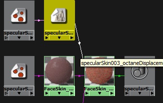

The issue seems like the shift uses a different calculation to the displacement. So if you have a large negative value it invariably tears bits of geometry.
franchus
Posts: 44
Joined: Fri May 13, 2016 7:57 am
Location: Barcelona
This is fixed using a ClampTexture node between the texture and the displacement node. The explanation of this is: Octane assumes gets the 32 bit value of an image, therefore there might be higher than 1 and lower than 0 values. The Clamp node corrects the interpretation issues.
