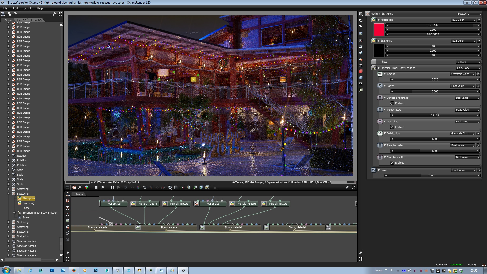

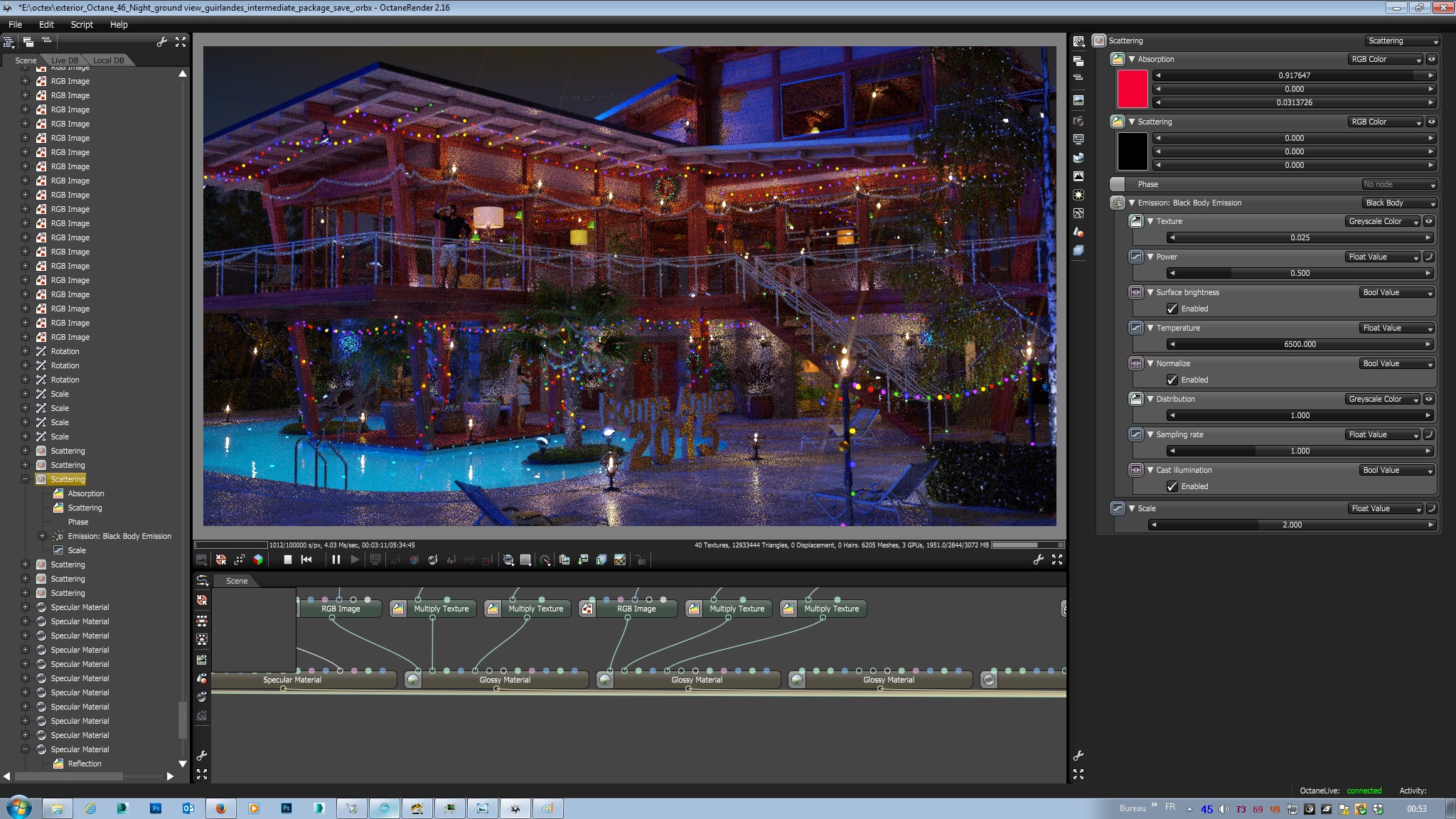

Dom74
Posts: 155
Joined: Sat Oct 23, 2010 7:16 pm
Blackbody emission is not working in material with scattering medium, it worked previously with 2.16a.

Dom74
Posts: 155
abstrax wrote:
Dom74 wrote:Blackbody emission is not working in material with scattering medium, it worked previously with 2.16a.
Hmm, here it works. Could you post an example?
Sure, here with v. 2.16a
and here with v. 2.20
With v. 2.20, there is no light in the pool.

abstrax
Posts: 5516
Dom74 wrote:
Ah ok. I was looking for emission in a diffuse material with a scatter medium. I found the issue and it will be fixed with the next release. Thanks for your feedback.
