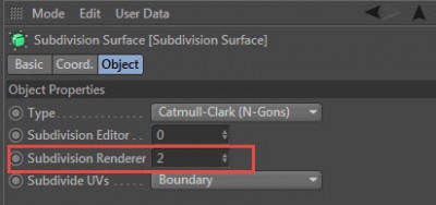

Hi, once again me....we have the same problem...we reduced the polys to 14 Mio...but the same problem :-(
Here another screenshot:
And also the LOG:
--------------------------- EXPORT LOG ---------------------------
Export materials time= 0.392 ms
Collect objects time= 60.094 ms
Meshes creation time = 3053.856 ms
Octane voxelization time = 0 ms
Sending to Octane engine time = 602.126 ms
CUDA error 1 on device 1: One or more of the parameters passed were not within an acceptable range of values.
-> failed to bind texture to device memory (data5)
device 1: failed to bind data texture 4 of context 0
<<< Render Failure >>>
CUDA error 1 on device 0: One or more of the parameters passed were not within an acceptable range of values.
device 0: failed to bind data texture 4 of context 0
Total export Time = 123555.102 ms
Can't Read Preset File: C:\Program Files\MAXON\CINEMA 4D R16\plugins\c4doctanepresets.dat
Get size:784 504
Posts: 16068
Location: Türkiye
do you have textures in scene?
gundf2012
Posts: 8
Joined: Wed Feb 26, 2014 5:23 pm
Just default octane material
Posts: 16068
Location: Türkiye
Strange if you really 14millions polygons. You may try without monitoring gpu. Also try to put a octane object tag on top of group. I cannot know without seeing more.

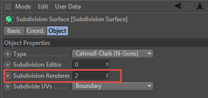

I'm having the same problem, but my Poly Count info says there's almost 4 millons polys. Any help?
One bag renders correctly, but I have a scene with several bags, so I'm using a cloner object with render instance turned on...
Attached the scene with the problem, thanks.
trest.rar
(18.12 MiB) Downloaded 1160 times
Posts: 16068
Location: Türkiye
statostado wrote:I'm having the same problem, but my Poly Count info says there's almost 4 millons polys. Any help?
LV is not using Subdivison Renderer. So you don't see real render triangle counts. Also use some latest versions of plugin. It has an optimisation to avoid using the base meshes double times.
