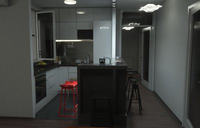

bought the extra 2.15 licence for network rendering - manage to work it out, but I continuously have issues such as, rendering stops at 7-8 samples, the other computer log says "expected tonemap type2 but got tonemap type 0"
- also plugin keeps on telling me I have to activate the plugin when no deactivation took place, on both the deamon and 3dmax plugin - is this a recorded issue, or should I worry that someone hacked my account and tries to use my account??
- now, I would expect more flawless working plugin - what sort of stuff do we need to keep in mind when working in network rendering mode - it's a bit crappy when I leave rendering on and it stops after a few seconds, only to find that out an hour later..
- on the upside - managed to get this interior rendering in 5 mins with 8 gpu cores - I'm thinking this could be done in an hour in full HD with more optimisations, which is great, everything seems stable so far, running an old heavy interior scene
- also is there a network monitoring tool to identify if connection broke or something?
- right now I'm chechking for temps to see if everything is working
EDIT> netywork rendering seems to work OK with no glitches on a new simpler scene -
quick zbrush doodle, and heavy material SSS mix
