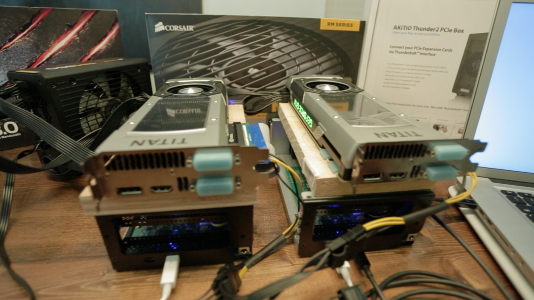

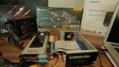

:) DO IT. it works perfectly well. My setup is one RM850 PSU, 2 Titan Black, 2 AKiTiO both with Powered Risers using thunderbolt daisy chain. ( I'm switching to 2 Titan Z this week ) Works perfect with my Octane Render C4D Plugin.
Im preparing a tutorial on how to put together all the parts and how to edit the .kext files. I will post pics later.

Setup Pics:
OS X Yosemite 10.10.3 | Macbook Pro | 16GB | 2 x Geforce GTX TITAN Z | Akitio eGPU | CINEMA 4D R16 |

Stealthworks wrote:
If you look at the spec for the AKiTiO PCIe box it says that Graphics cards are NOT supported.
Are you using something else or have you just found that even though they are not supported they do still work?
I'm really interested in this technology as I only have a macbook pro but just want to know, will it actually work despite the manufacturers specification?
Yes the specs says that Graphics cards are NOT supported but it works.
Check my setup pics, I got 1 and 2GTX titan black using thunderbolt daisy chain.

mustardseedsg wrote:Jose and garytyler: how is the noise levels on your setups?
I'm running x2 GTX780s and the fan noise brings me back to my Powermac Quad G5 days... And let's not even talk about the heat!
Noise is not bad, heat is crazy but you can control it. The good part is that I can render with my MacBook Pro, so I don't care that much about the noise. :D

Jose, You've daisy chained those two from single Thunderbolt? =)
