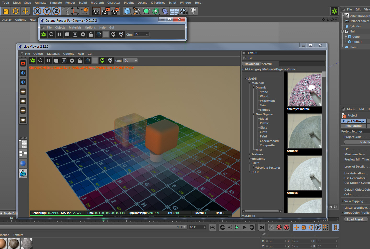

Hi again,
i need a volunteer to test new gui. As you can see that octane and live windows can have menu and icons. Also some icons and commands can be allocated on anywhere. Even it will be possible to use Live Viewer without Octane dialog.
But there is a side effect. Which is that gpus cannot go to real idle mode without closing Live Viewer. That's the biggest reason to keep Octane Dialog.

aoktar wrote:Hi again,
This new Live Viewer Gui is just amazing . Remove that Octane Dialog window completely if you can . Just don't get it, about what IDLE stuff everyone are begging. For me all idle stuff works without issues. Start render -> TDP grows . Pause render or stop -> TDP drops.
Maybe I'm missing something?

I'm glad to hear that you like it. Currently it's more customisable. You can use Octane dialog or LV with icons and menus. I'm not sure to remove fully that. Because need more time to be sure we don't need anymore. We'll see after released.
On LV, "Reset button" resets all data and drops TDP to idle. But stop does not do it. Second alternative, disabling all GPUS.

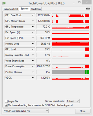

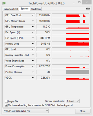

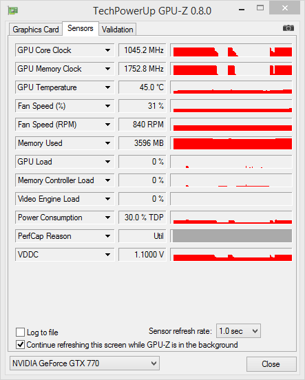

Ok. I've got it. You mean deep IDLE stuff. For me that doesn't matter.10-20 W per hour difference.
That's how my system works and i'm pretty happy with that.
No lag and everything smooth and responsive.
If you can't live with out those deep IDLE stuff , just hit "Reset button" like Aoktar said. That's all ;)
When rendering in octane
When any 3d or 2d programm started
When you do nothing
When you do nothing
