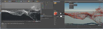

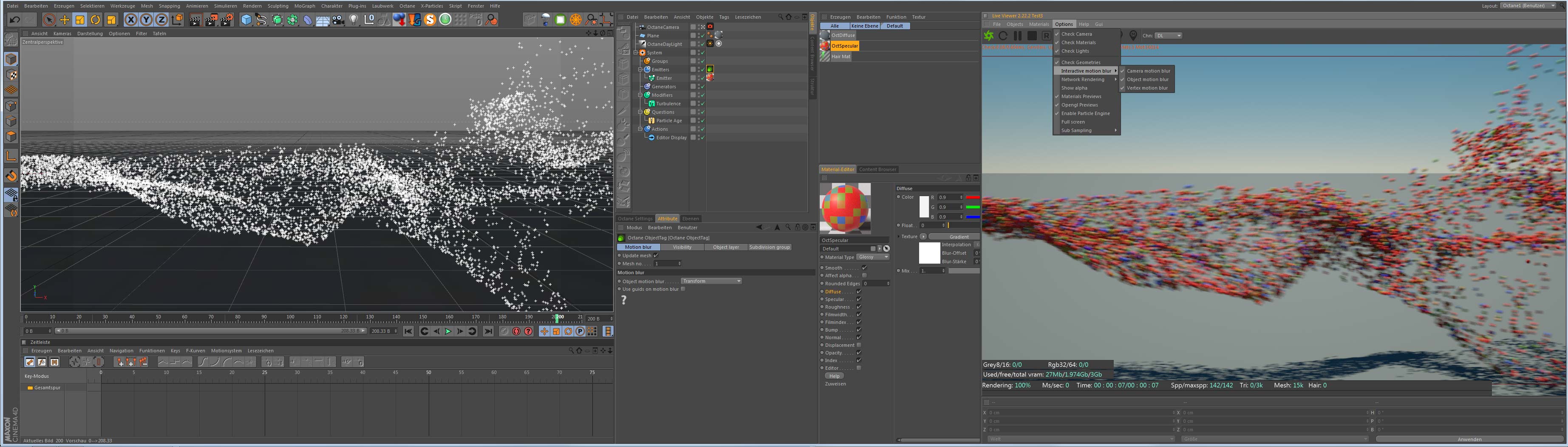

xparticles motion blur
Posts: 16068
Location: Türkiye
you need to play or cache xp
Janmansilver
Posts: 46
Joined: Wed Apr 22, 2015 3:05 pm
Still nothing
Posts: 16068
Location: Türkiye
There is a new scene
XP-motionblur.zip
(142.75 KiB) Downloaded 226 times

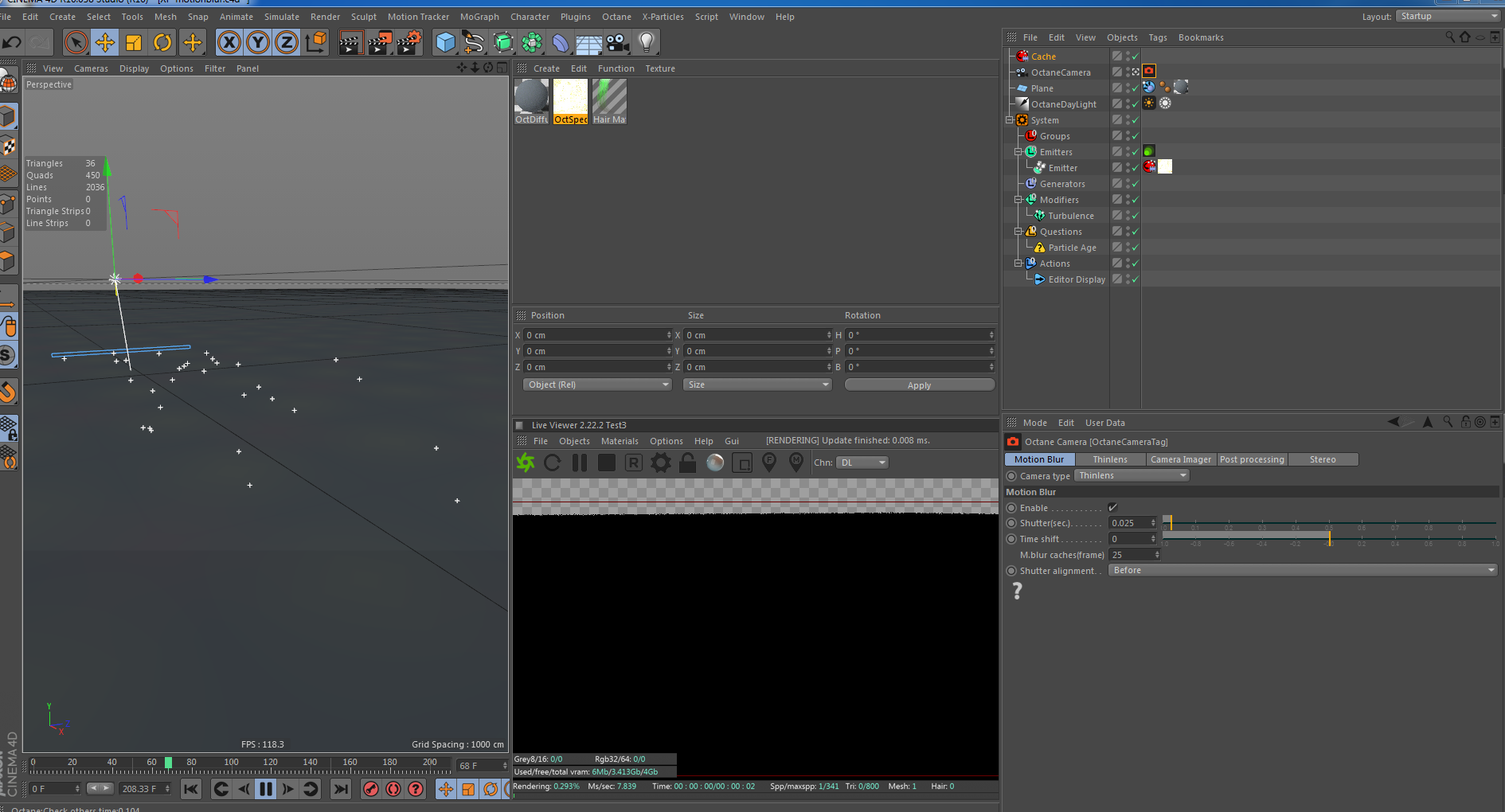

Janmansilver
Posts: 46
Thanks a million, I can get it working now in the final render, but not in the live viewer (even though interactive motion blur is activated). But that's not a big issue, as long as I can get motion blur on the final result. :-)
