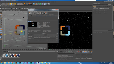

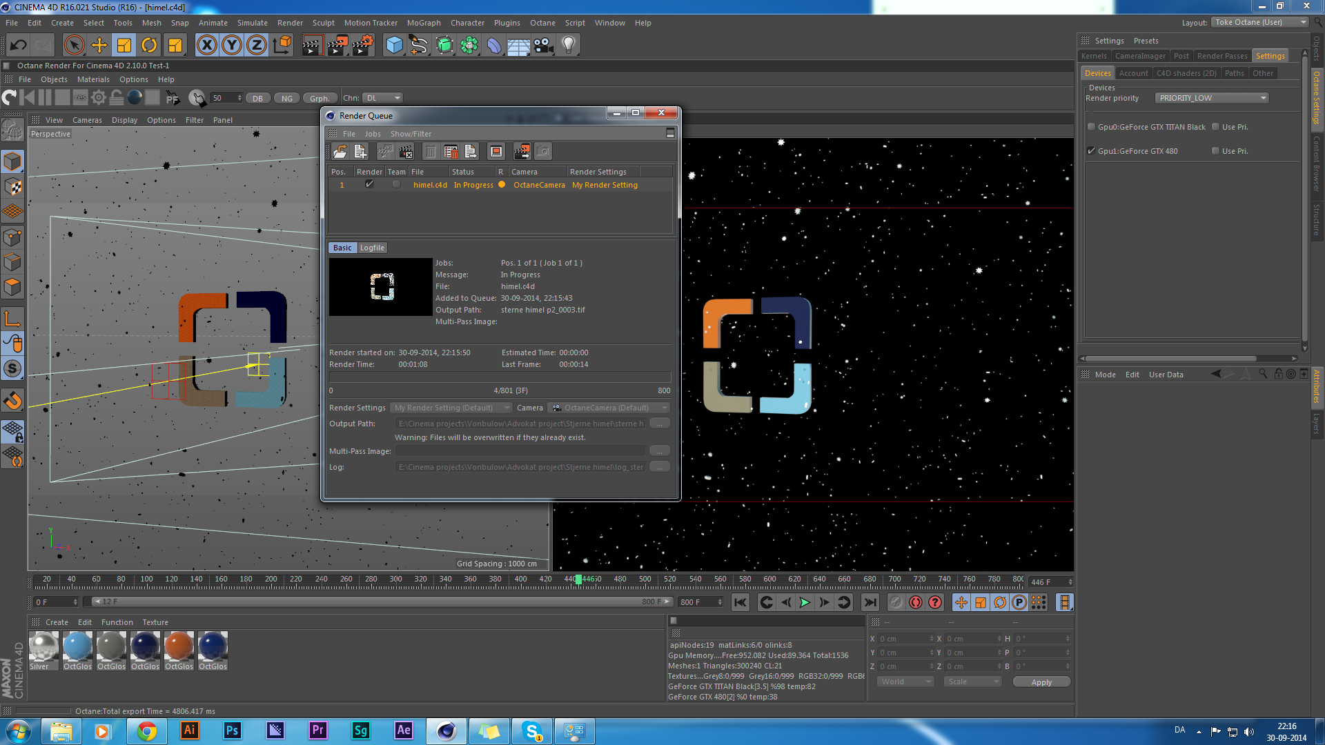

look now my titan is swicht of but down you can se that is the gpu running or mabey i jsut don't understand those settings ?
Posts: 16066
Location: Türkiye
this is a bug on plugin. But cannot fix it. It show swapped the usages of cards. But not on every system. I'm using a external api to read temps and usage. It gives uncompatible order of gpus against to Octane sdk. If you select any gpu, this means that's active

Selection is working well. Problem is out of my control. Depends to nvidia api. You can use "msi afterburner" to be sure which is running.
