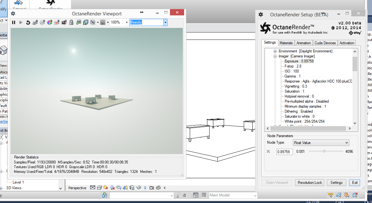

Hi Paul
All the textures are missing.
I can now render like yours but still getting the 4 characters error message similar to previous posts
FYI
It doesn't crash anymore.
Again - my apologies for the problems you are having....
I loaded your scene in Revit 2014, with 2.10.0.12, and yes, the texturemap pins are blank. So I "Reconvert from Revit" for each material, and it renders fine. As a test, I installed 2.6.0.9, loaded your scene, "Reconvert from Revit" each material, saved, installed 2.10.0.12, started Revit, loaded the saved scene, and it found all the texturemaps.
I checked in the Octane data in the crash scene you sent me, and all the texturemap references are blank.
Is it possible your "Default" materials have a reference to a texturemap location which is no longer valid? If an Octane material refers to a texturemap which does not exist, the filename is blanked in the Octane image node.
EDIT: Another question - What was the previous version of the plugin that you were using pls?

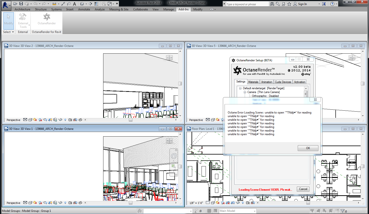

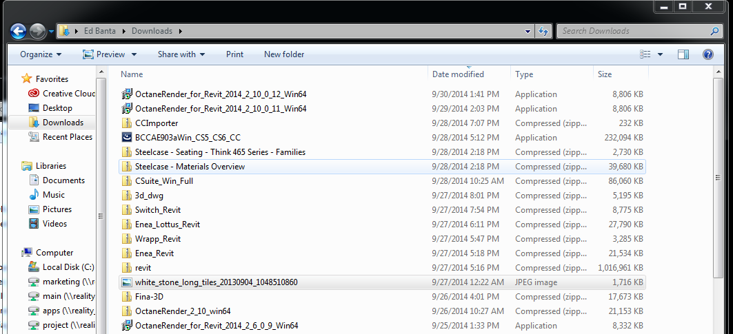

Paul,
I also installed the latest version and had it crash. The installer I downloaded was only 8,806 KB. Is that right?
Ed

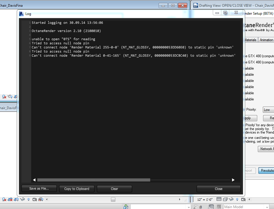

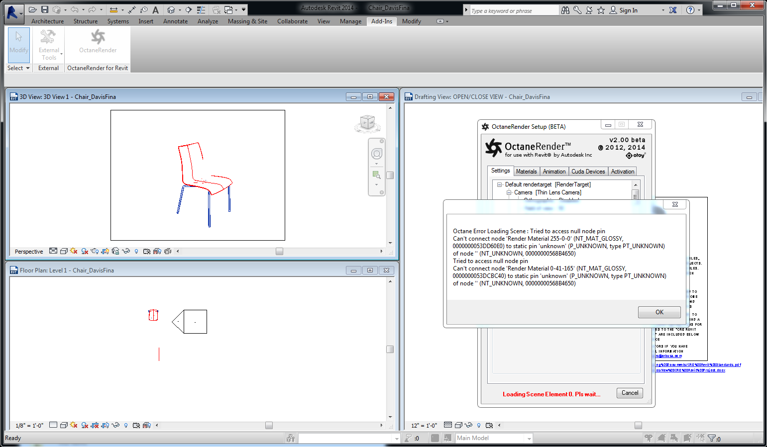

Paul,
I also tried the latest version with a simple model of a chair and had a similar result. Since it's small, it may help isolate the issue.
Ed
Chair_DavisFina.zip
(4.58 MiB) Downloaded 399 times
face_off
Posts: 15799
Location: Adelaide, Australia
Hi Ed - what does the "latest version" mean pls? Which release number?
