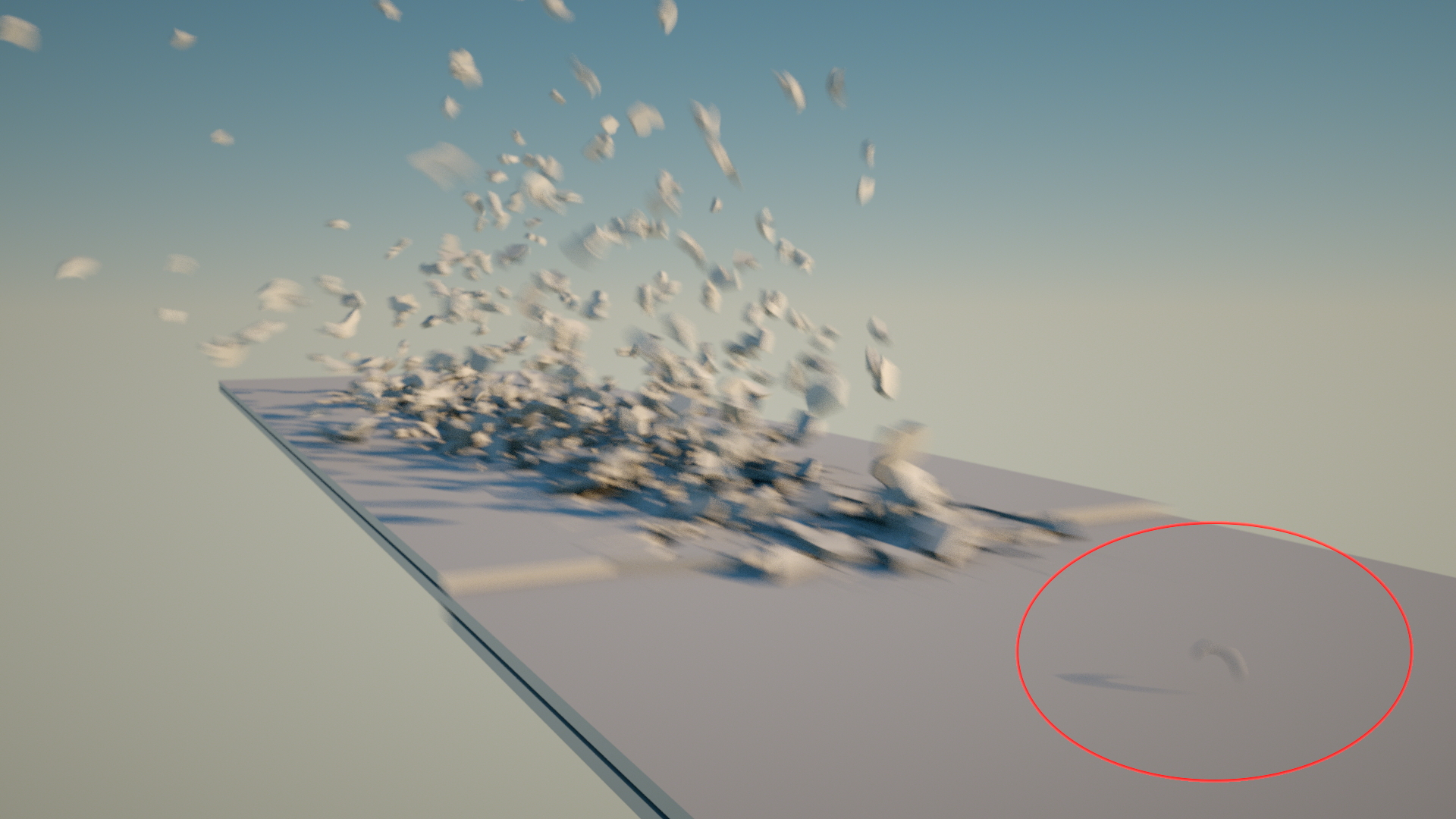

profbetis wrote:Thank you Karba! I know you are busy so I appreciate this. I know a majority of users may not benefit from this, but those of us pushing the renderer to its limits are! :)
I got your scene.
Unfortunately it is time precision issue of 3dsmax. you have very fast motion in very short period of time. So there is nothing I can do here. Try to increase motion duration and reduce the speed.

Karba wrote: I got your scene.
Oh, very interesting. I noticed that the animation graph looked strange inside Max as well when zoomed into to such an extent. Thanks for looking into this.

I just realized that in the kernel settings I can set the motion blur duration to greater than 1.0, which totally makes my motion-blur based workflow way better. It also essentially fixes this problem. :D

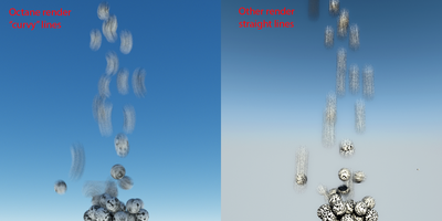

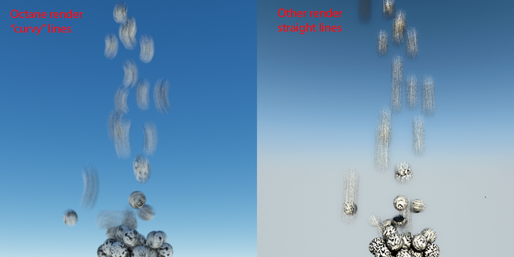

Hi Karba,
Sorry to reopen this case but i have the same issue of not understanding the behavior of this motion sometime.
I will think in a case of a sphere rotating on herself and falling down straight that yes the motion blur will look overall straight but the pattern/texture on it will look like it's rotating.
I render some spheres falling with some rotation on themselves to illustrate.
It seem like the overall trajectories of the spheres become "curvy", is it what it should look like :? ? (I'm using octane standalone 2.14)
I render the same alembic with another render engine in maya and the result look like straight lines and that what i was expecting so maybe the way octane is doing it is the good one :P but I just want to make sure again as i'm a little bit trouble by that :D
Let me know what you think,
Thank's,
Ben
To see it in motion: (password : "octane")
octane render with no motion blur
https://vimeo.com/113453836
octane render with motion blur, shutter 100%
https://vimeo.com/113453835
The other render engine with motion blur
https://vimeo.com/113453834

The octane version looks wrong. The motion of rotating spheres should be straight, unless you are not rotating around their centres. This could only occur physically if the spheres weight was not even. eg biased to a side.

Yes, that's what I would think even if i don't have a physical explanation :D . I feel that it was the same problem for "bcravin", that why i posted here.

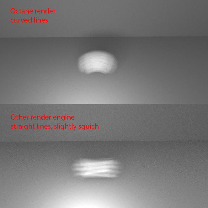

Making sure it was not coming from the alembic interpretation I did another test just with a simple sphere rotating around his center. The result is the same, some curved motion blur in one direction. (I render it with the maya plugin).
Here are the motion test video with the sphere - vimeo password: "octane"
- Octane with motion blur
https://vimeo.com/113662654
- Octane no motion blur
https://vimeo.com/113663093
- Other render engine with motion blur
https://vimeo.com/113664591

I can't reproduce the issue.
What kind of MB do you use? object MB or vertex one?
Could you send me a scene?
