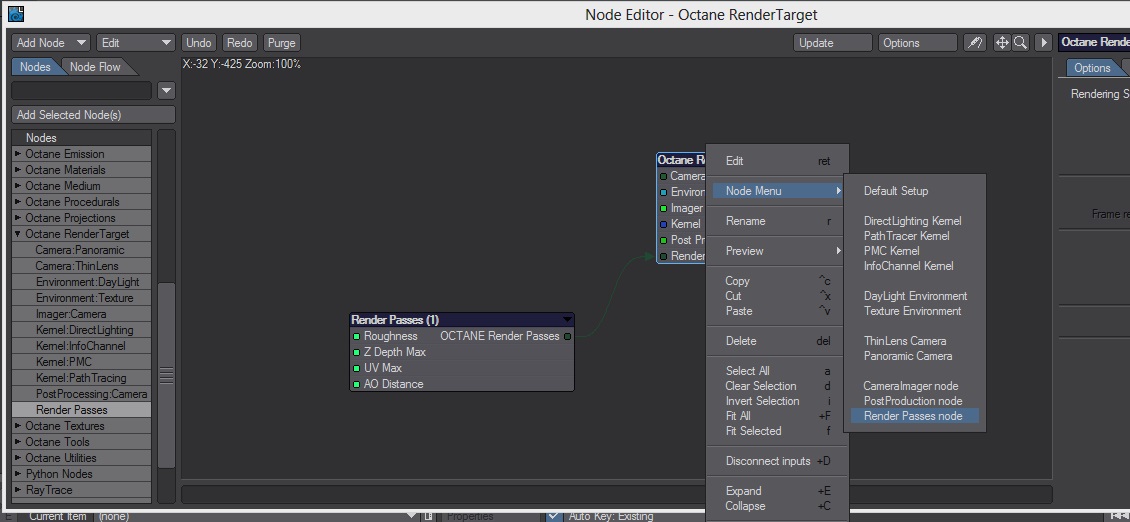

Is there any "tutorial" how to use passes in plugin ? I see "render passes" connection in the camera target but have no idea what node to connect there ?

Lewis wrote:Is there any "tutorial" how to use passes in plugin ? I see "render passes" connection in the camera target but have no idea what node to connect there ?
Right click over the root node and you can see a new "render passes" node in the context menu, or in the render target nodes group.
