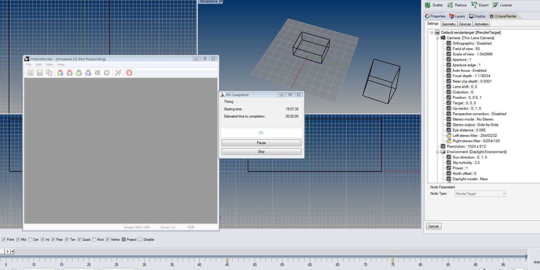

However, still having a couple of issues:
Rendering from Bongo (!_BongoRenderAnimation) freezes (see attached image). Tested with Rhino Render and all appears fine - very simple scene (as pictured) and only settings in Octane changed were to reduced the max samples to 160 from 16000.
