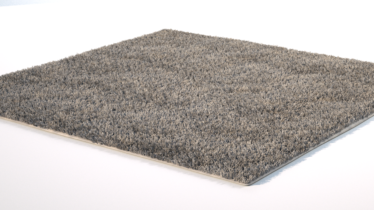

Kaiwas - You need to make sure that the mesh type is set to "scatter". I was just working on a rug following one of Andrew Price's tutorials and using Octane hair.

Is it possible to make FLAT hair and fur. (as grass)?
JimStar
Posts: 3852
kaiwas wrote:Is it possible to make FLAT hair and fur. (as grass)?
No.

interesting thing
full size 1920x1080px. 2000 samples 1h 30 min (100% crop)
border render 300 samples 10 min (100%)
