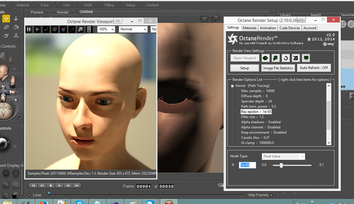

Hi -set the subdivision level of the mesh to 1 - DOES NOT SOLVE THE PROBLEM!
Below is Roxy, at subd 1 (in the Octane settings), with sun size 2, and ray epsilon 0.00001. I don't see any artifacts.
Also - as Zay rightly says, you can rescale the scene in the Configuration settings to get around this.
Paul
