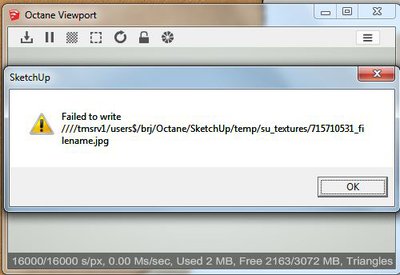

sketchup pro 8 > octane plugin version 0.10.6.21
sketchup 2014 > octane plugin version 0.11.53
Error writeing texture

i have checked, and "\\tmsrv1\users$\brj\Octane\SketchUp\temp\textures" does exists.
but the error says "\\\tmsrv1\users$\brj\Octane\SketchUp\temp\textures"
if i use sketchup 8.0 and octane plugin version 0.12.142 (the same version as installed with 2014) it saves the textures the same place - with no problem.

hi fuzzi
i still get this error this frustration error, even with Sketchup 2015 and Octane plugin 0.13.82.
i really don't know what to do - sketchup 8.0 still works fine.
i have been talking to our network / server provider, they say that everything is ok on the server.

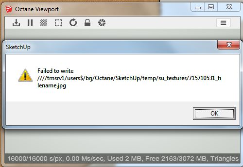

i think that there is something wrong with the path that Octane tries to use:
this does not work
////tmsrv1/users$/brj/octane/sketchup/temp/su_textures/
this works
\\tmsrv1\users$\brj\octane\sketchup\temp\su_textures\
i'm sorry that our userfiles are on a server - but it's out of my hands.
