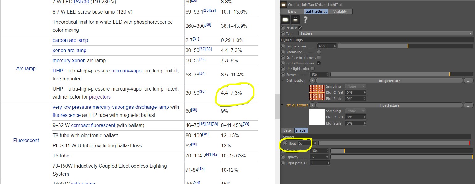

OctaneRender does't use lumen, the power of light is espressed in Watt + Efficiency/Texture.
As you can see from the following link, different lights have different efficency, and have different lunem with the same Watt value:
http://www.rapidtables.com/calc/light/w ... ulator.htm
At the following link you can find a table (the second one) with different efficency values in % for different type of light sources:
https://en.m.wikipedia.org/wiki/Luminous_efficacy
So in Octane, set the Power in Watt, and change the Efgicency /Texture value according to the type of light source.

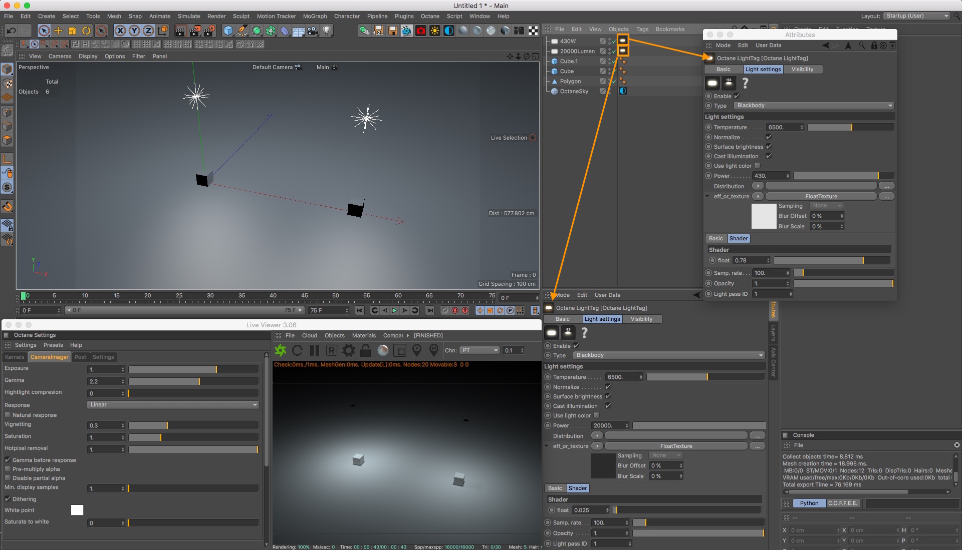

Hi VVG,
no, 5 is way too high as efficiency.
Please, look at this example, the first light is 430 Watt with an efficiency of 0.78.
The second light has the power in Lumen and low efficiency, If you don't want to use the efficiency, you can leave the node empty (the default value is 0.025) and use the Lumen value in the Power. As you can see, the result is quite similar: ciao beppe

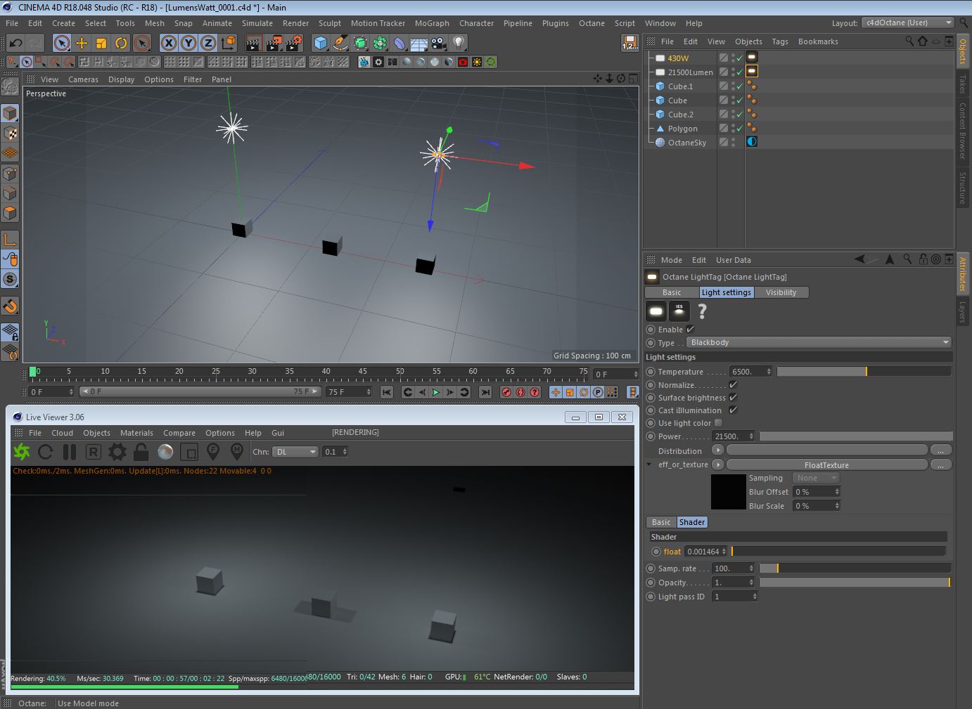

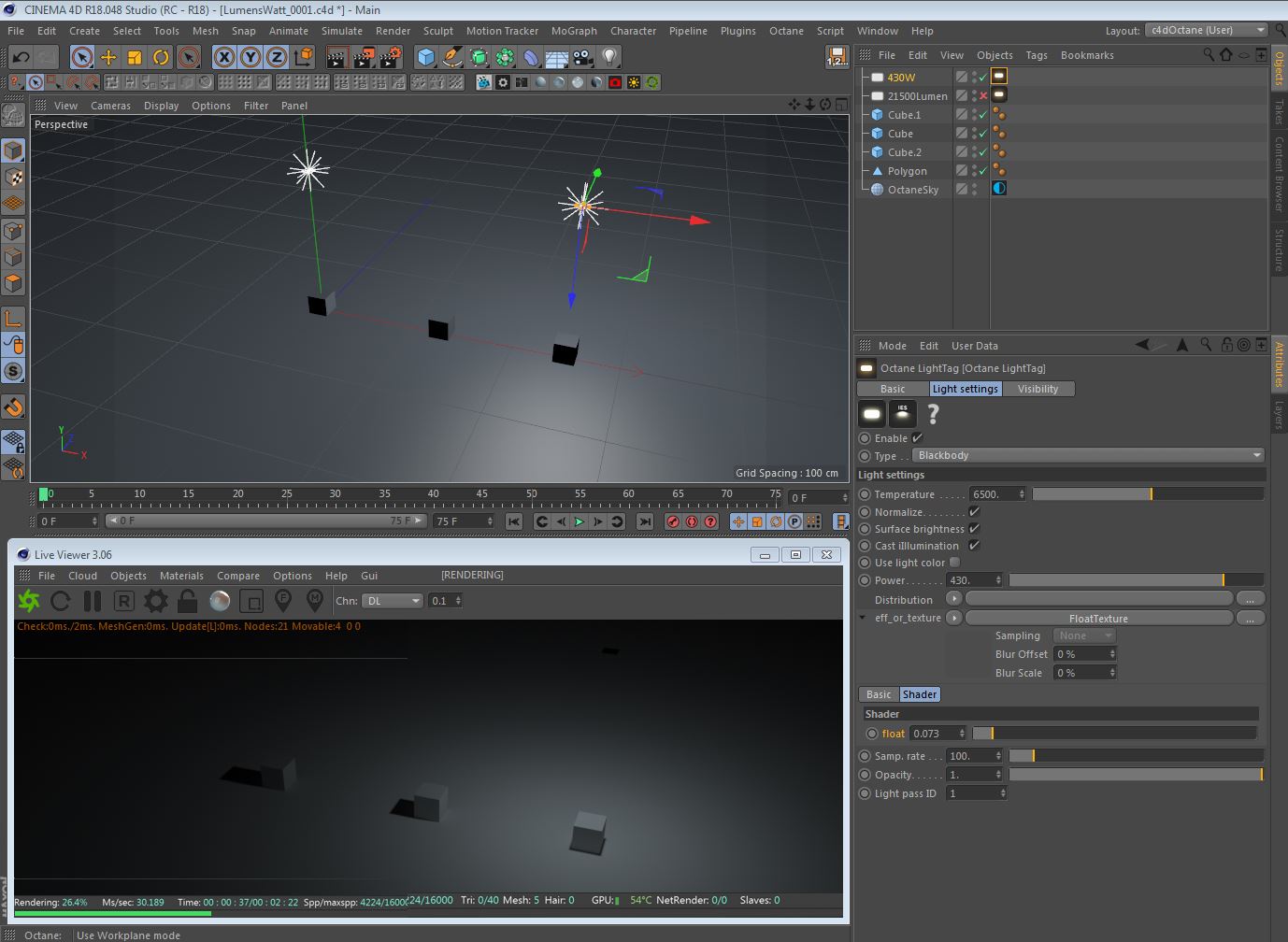

Hi VVG,
sorry my scene is heavily approximate and the efficiency value used is wrong.
I have revisited the example scene with Paride that is more expert than me on this argument, and here is the exact values to work with Lumens in c4doctane:
As said, to get the correct light in Octane we need the Watt and Efficiency values. In your Example, the light has 430Watt amd 7.3% of efficiency equal to 0.073 in octane: Now let's say that we have the only the Lumen value, that, accordingly to this calculator, for your light should be 430 x 50 lu/W = 21.500 Lumen. To obtain the same light knowing only the Lumens value, we need to use the Lumen value in Power, and 1/683 = 0,001464 in the Efficiency float value: The Lumens-Watt translation is quite complex and involves also the temperature and the Normalize parameter, but for a general use, this conversion should be more than enough.
Let me know if it works also for you.
Happy rendering,
ciao beppe
Happy rendering,
ciao beppe
