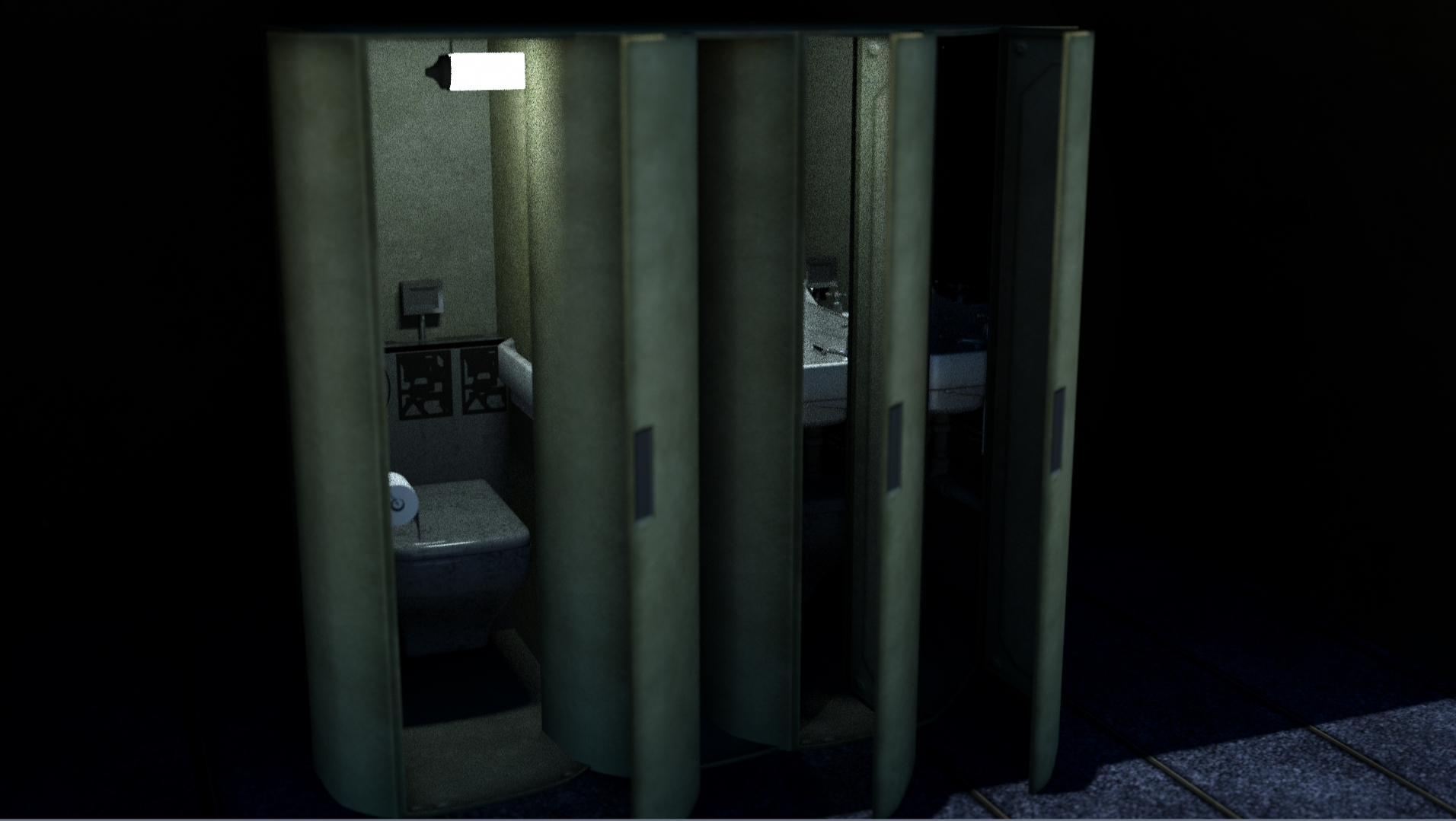

UPDATE.
This might help. In my haste I forgot to close down Carrara, and guess what? It merged the scenes! (In the Octane render only, the carrara scene file is fine). Here the old scene has two booths, the new loaded scene has one.
Just look at the picture! We have 3 booths with the one in between the two. So something is not being cleared down. Hope this helps.

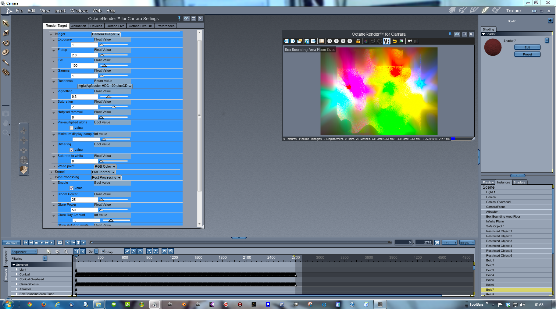

Hi Sighman,
Hope you dont mind but I thought I might take advantage of this and make use of the same build too!
Basically its regarding the 'Blue RT Settings' issue which I can now reproduce upon call..
Here is a link to my dropbox with three separate videos recorded directly one after (don't worry, very short clips) the other showing how the issue is reproduced and providing log files. I did not include scene files as it takes up space and besides this happens on what ever scene I have open so is not project dependent!
(Dropbox link sent in PM version of this msg)for privacy.
PS: I don't expect you to jump on this right now as it is not a high priority issue, just thought it might help you to have data to examine when the right time comes
Regards, Orion.
Regards, Orion.
