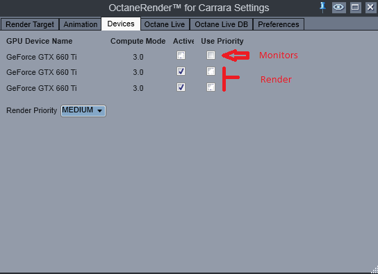

For a three card setup I would plug my monitors into one card and use the other two for rendering. As Tugpsx suggests I would Activate one card at a time to determine which one the monitors are plugged into. Then deactivate the one you are using for the monitors and activate the other two without priority.
If you want to use all three then enable priority only on the monitors card but you will loose some memory if you do.

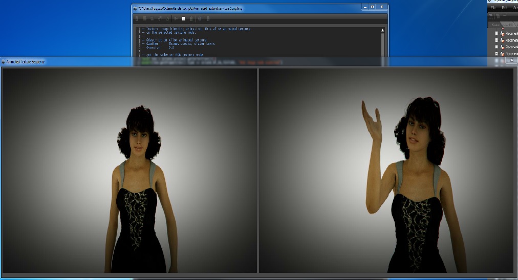

Thanks guys, I have to finish my animated texture script for standalone. I haven't worked on it in a while.
Animated Texture Script
Ohh, like the sound of that :) Been quite a while since I used the standalone let alone look at the scripts! Last script I looked at was the turntable one :lol: :lol: :lol:
