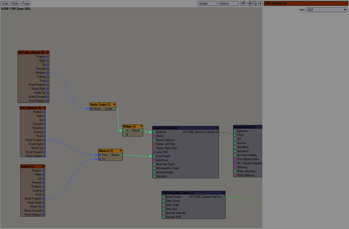

Hmm, weird.
Must be different DOF setup then.
Here is my setup.
1. DOF null and Camera are connected to Focal Lenght so when i move null I determine where focus should be (distance).
2. DOF null is connected to aperture through vector/scalar nodes so when i rotate null on "H" channel i get more or less blur like "DOF amount"
what setup are you using ?

MrFurious wrote:Me or Ryan?
So DOF tweaking in OpenGL not working for you?
Both of you, or anyone for that matter :).
I'm not speaking about OGL DOF (i know about that but it's too slow for scene with lot of instances and since i need instances to be bounding box it's rarely useful for my scenes anyway). I need IPR DOF in Octane and this setup doesn't work without reload button hit.
thanks

Lewis
Posts: 1108
Joined: Tue Feb 05, 2013 6:30 pm
Location: Croatia
Sorry Redraw not Reload (that would be very bad yes :)).
Still even with redraw it's pain when tweaking IPR/DOF so I'm curious to see your setup whit FSPE on that redraws automatically at IPR 'coz mine isn't.
cheers

MrFurious
Posts: 529
Joined: Wed Oct 23, 2013 5:46 pm
Location: Melbourne, Australia
FSPE doesn't seem to have any effect on my system, but this is how I setup DOF. Functionally ours both seem to work the same (requiring an IPR redraw) however if you ever need to render out a pass in LW this is the way to go.
http://render.otoy.com/forum/viewtopic. ... &hilit=dof
honestly I don't see a problem hitting 'alt-r' (or frameshift left right) after a DOF tweak to see it update. Takes a fraction of a second and now I do it without looking at the keyboard
