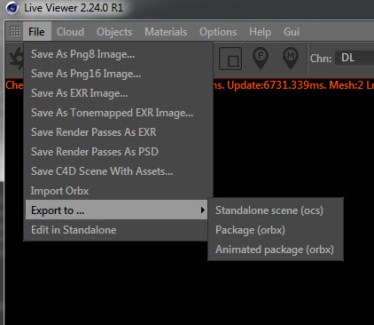

There is two commands for you.
1- Package orbx
2- Animated package orbx
As you may see 1 for stills and export as in LV's export structure. 2 is exporting all geometry as a ABC files and connect materials,etc... Takes more time to export all frames. Second one had a problem to assign materials to Arealights. In my wip version, i fixed this issue.

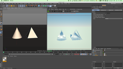

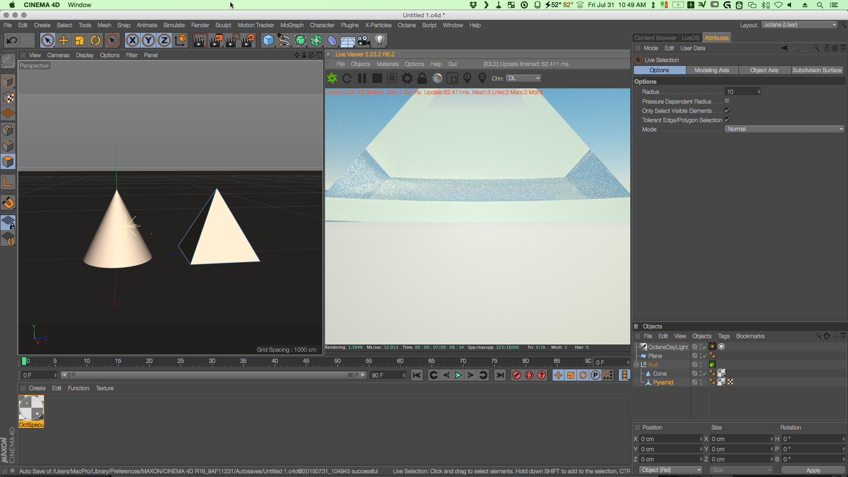

I did a quick scene to illustrate for you.
before
after exporting

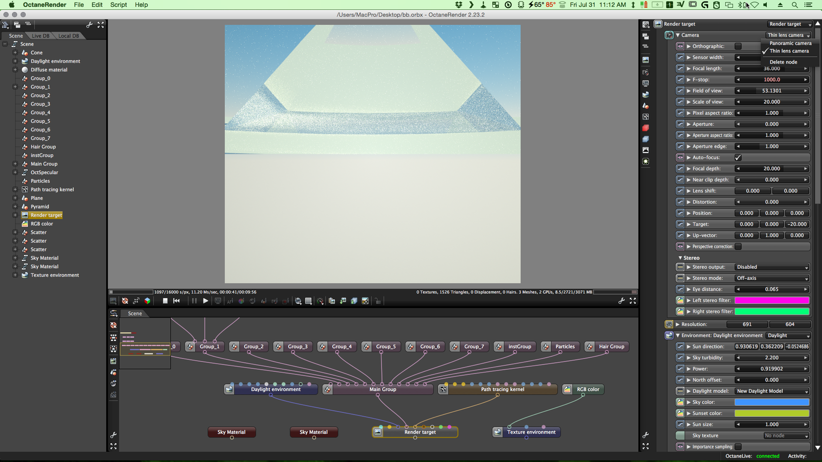

Don't worry about camera in LV after export completed. Just open exported "ORBX" in Standalone as i did. If camera is not connected to Rendertarget, connect it by manually. See my image.

I'm not seeing a camera in my exported scene, either ocs or orbx. The cam dropdown only shows thin lens or panoramic where you had shown "scene".
