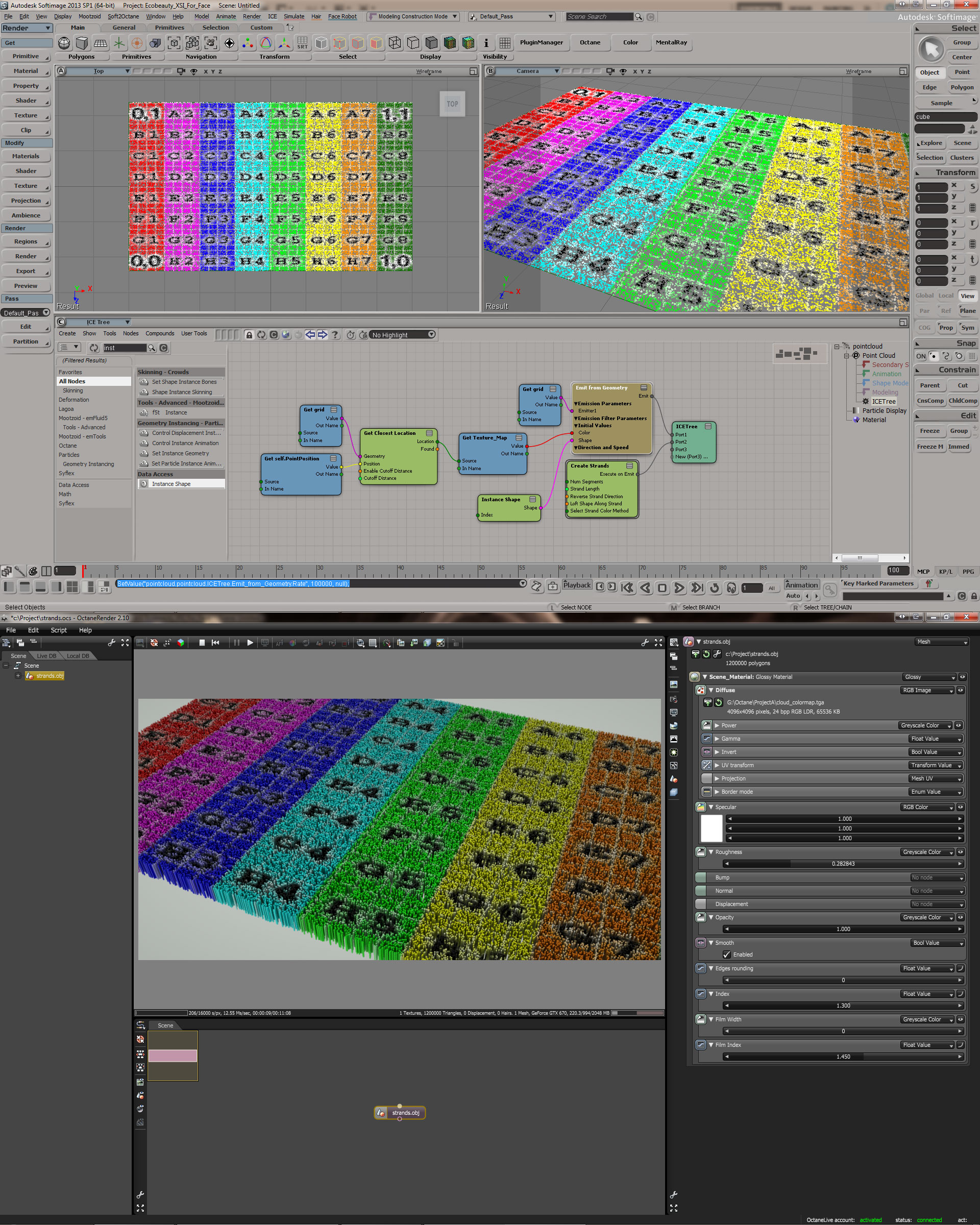

As example you create a grid, then apply a texture map on it via Property->Texture Map->XZ.
This can be used in the Render Tree and can read in into an ICE Tree like in the scene file below.
strands.zip
Softimage 2013 Scenefile
(275.65 KiB) Downloaded 793 times
Then apply an instance shape to it. This shape shouldn´t have a texture projection.
For performance and if you dont want to export it, you can hide the instance shape.
If you turbulize the strands, the instance shape should have the same subdivisions on y like the strandsegments -1.
The shape should also lie on 0,0,0.
Remember, more segments will increase the export time.
Hope this helps a little bit,
