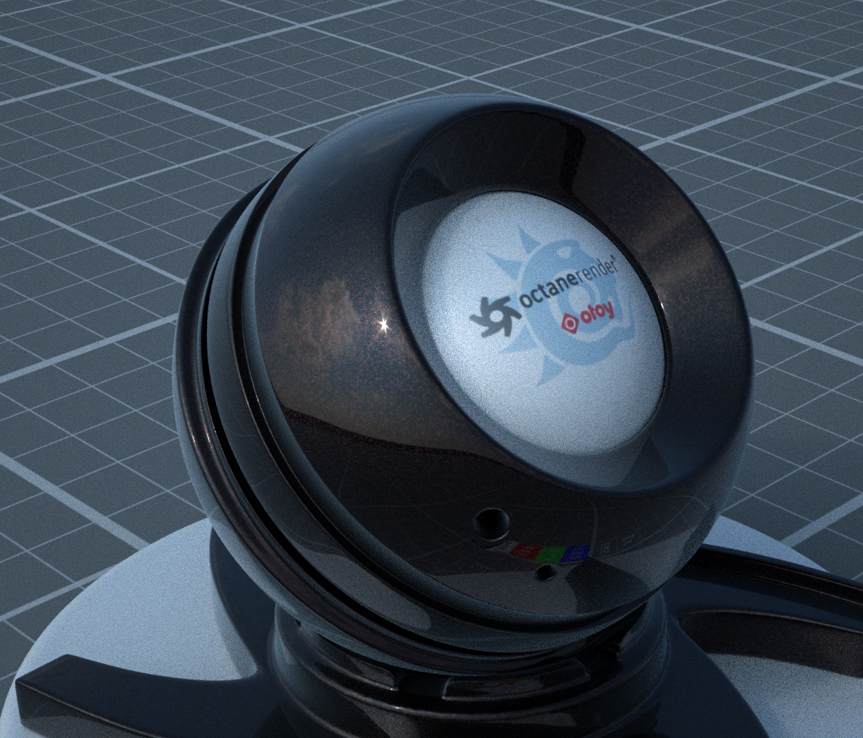

Yep, looks very good, now how do you transfer/export that to LW surface/pst :)?
Lewis
http://www.ram-studio.hr
Skype - lewis3d
ICQ - 7128177
WS AMD TRPro 3955WX, 256GB RAM, Win10, 2 * RTX 4090, 1 * RTX 3090
RS1 i7 9800X, 64GB RAM, Win10, 3 * RTX 3090
RS2 i7 6850K, 64GB RAM, Win10, 2 * RTX 4090
geo_n
Posts: 350
Joined: Tue Feb 02, 2010 5:47 am
Its mixer node with two glossy node plugged in.
Not sure how the values from octane transfer to lw octane values. Trial and error. Juanjo seemed to follow lw convention not octane convention for values.

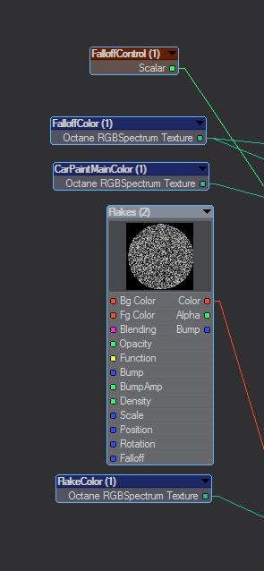

Well the carpaint material uploaded before is a mettalic paint, you just have to play with the controls a bit, i uploaded the material with all color variations close to black.
I changed the material a bit, all controls are on the left side now, "FalloffControl" controls the transition off the main color to the falloff color at grazing angle, "falloffColor", "CarPaintMainColor" and "FlakeColor" control all respective colors, use the flakes procedural input to control the size off the flakes....i changed the mix node off flakes specular controle so that the flakes are more pronounced...
