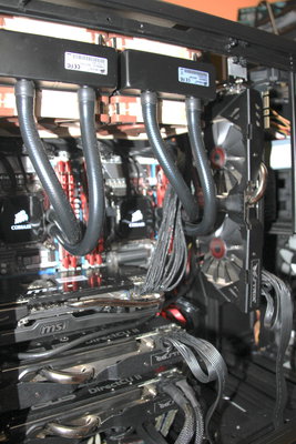

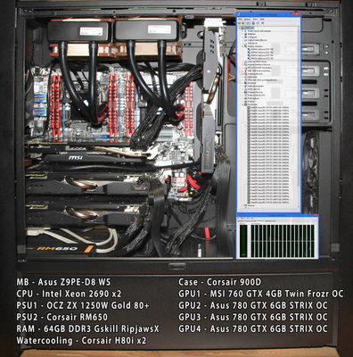

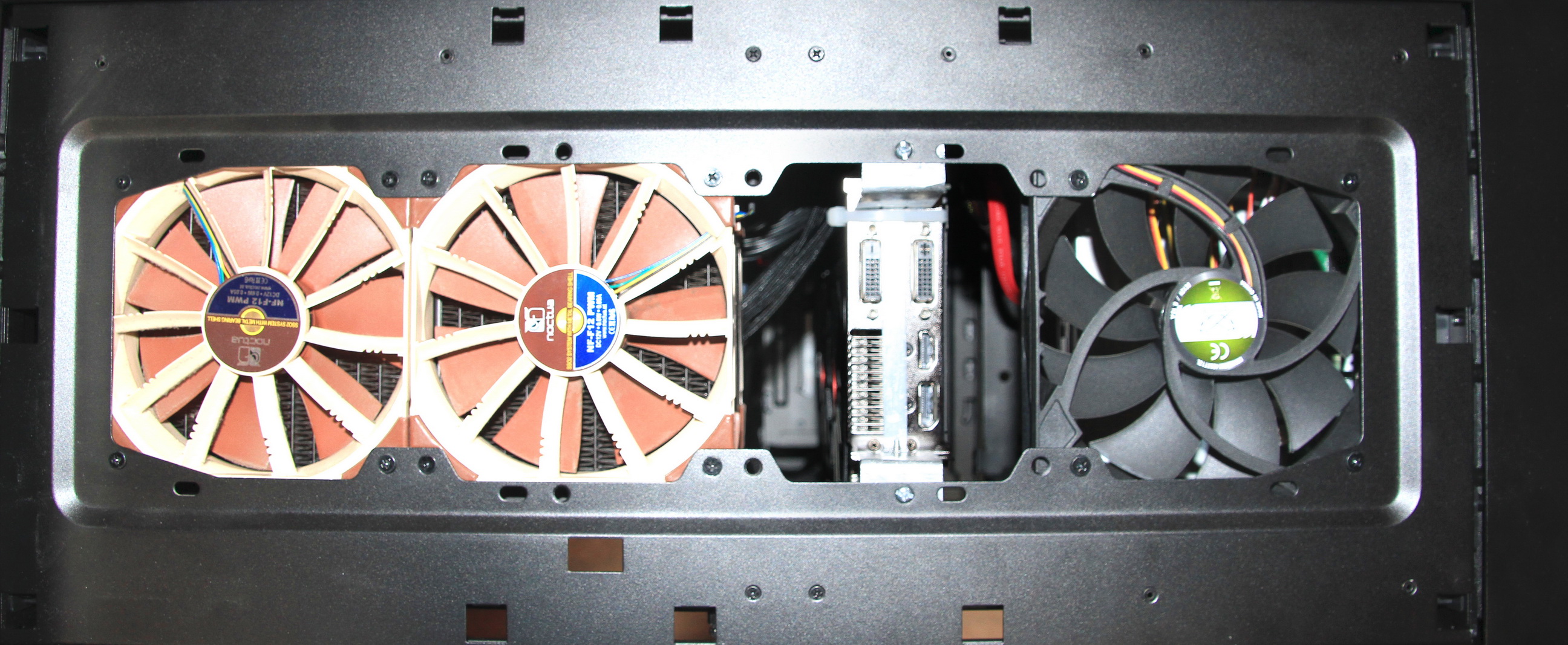

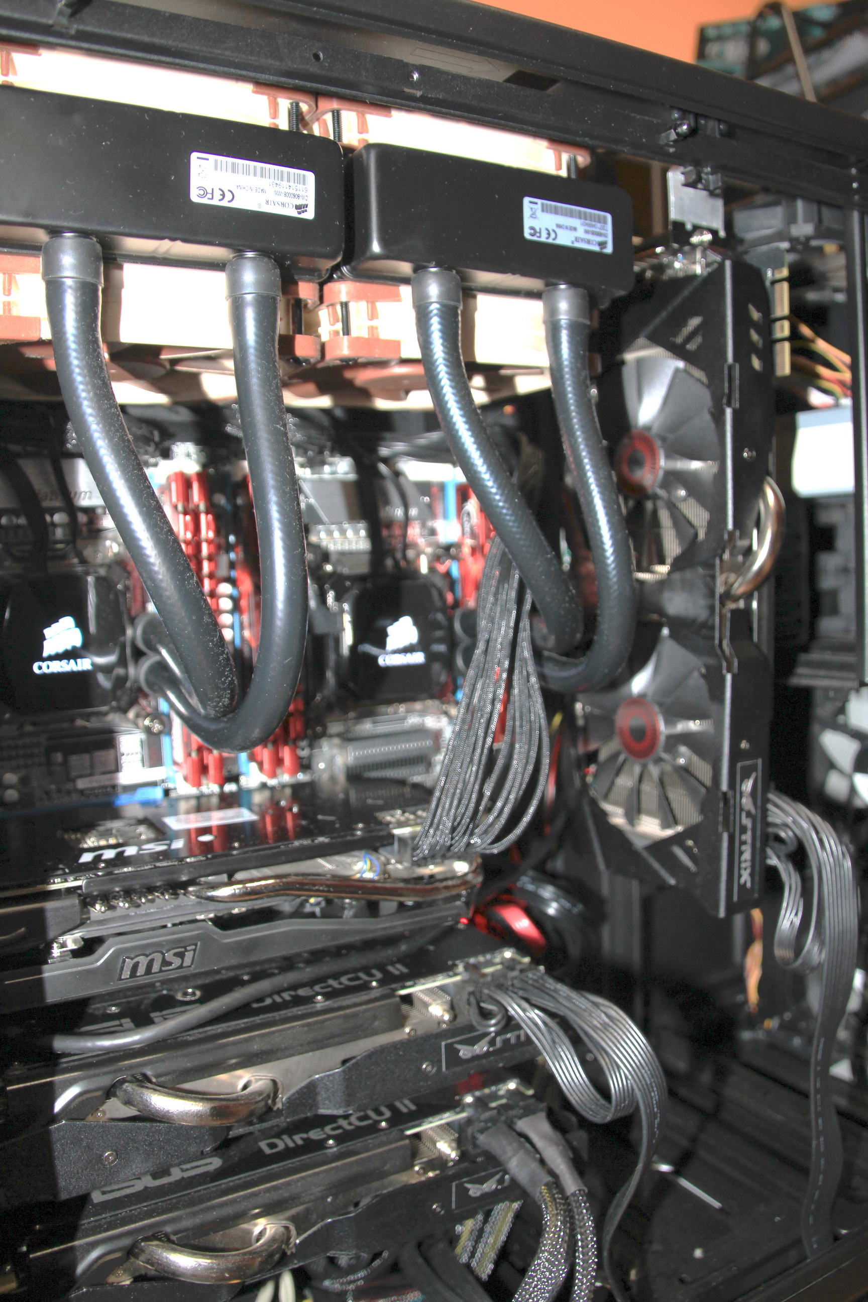

Yes still fine. A s matter of fact I've added 4th GPu (760GTX 4GB) just for windows image (so that all STRIX are free of display) and temps for STRIX cards are from 65-75 depends where is card positioned. I can't go to water-cooled version anyway since vendors don't have water block for STRIX cards yet (different PCB). The one sitting in vertically (custom made holder) is coolest and middle one is hottest.
Here is my current setup in case:

Now for Your rig! =) thanks for photos! it's nice to see such innovative housing. I can understand why that vertical card runs cooler - more air to breath =) P.S. h80 with noctuas is awesome, done a build not so long ago..- barely audible..Love those fans!
as for waterbloks, You can try to use those from EKWB EK-Thermosphere that fit "all" 6xx/7xx cards, but if You would be planing OC should very be careful with temps on memory & power (think ekstremeRigs have a video, that with custom bios'es 780/Titans power delivery can get up to crazy temps) even with full covers..
