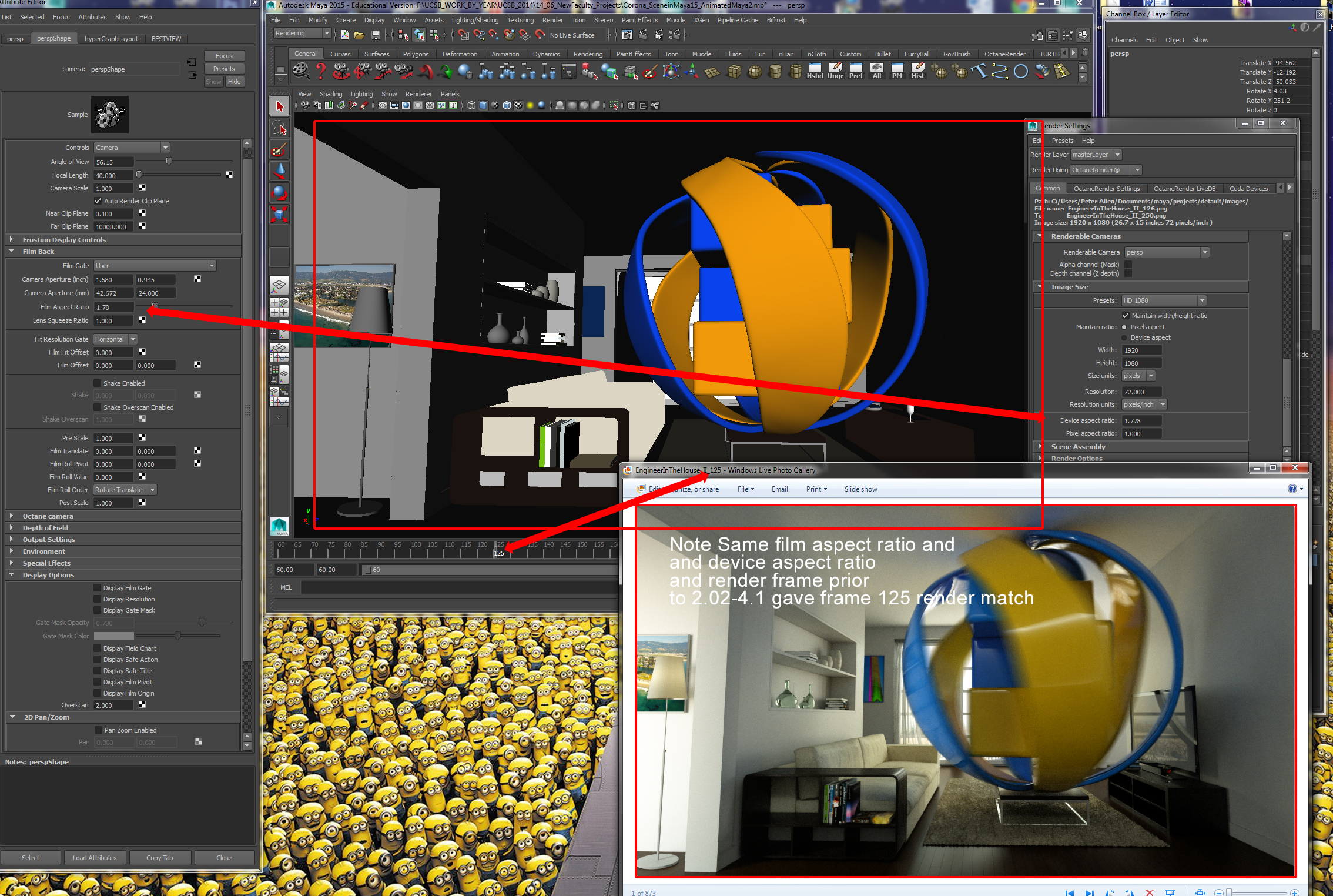

If you look at these two images you will see the only thing that has changed is the gate is turned on.
Based on the aspects matching this should not cause the camera to change like it has.

Sorry, so far I don't see here any problems. Moreover, I see the problems in previous versions where Octane's camera FOV was calculating wrong in some cases. Now this issue is fixed, and yes - it can now look differently on your previous scenes. But now - it looks how it must be.
Now it renders the resolution gate which is fit into film gate according to currently set "Fit Resolution Gate" setting. If you have the same aspect ratio in both - it is the same as if you render the film gate. The FOV of Octane camera is calculated from focal length and film size set in Maya's camera settings. No matter what size and aspect your current viewport is.
