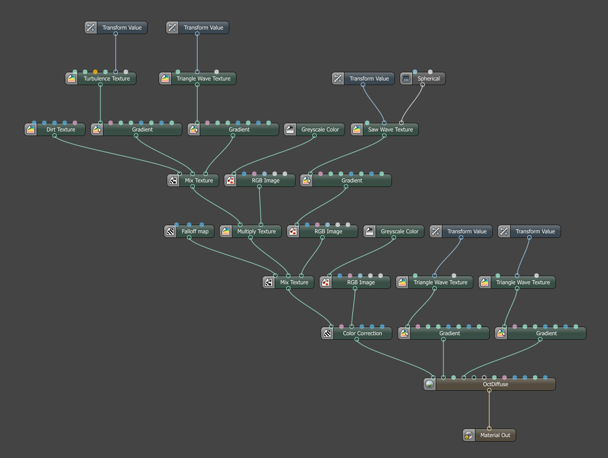

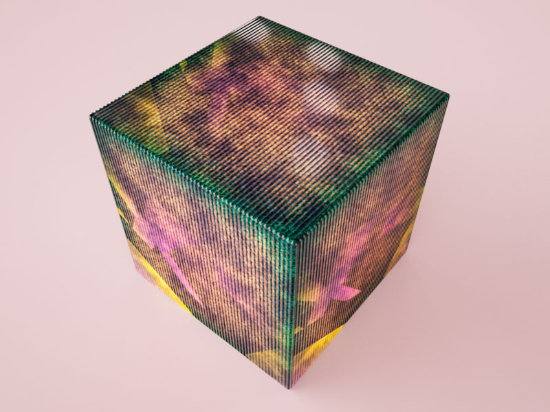

There is a lot of possibilities with the node system. Each node taken alone seems to be "not enough" but it's the mix of nodes the big strength of Octane. Here a sample of structure a little bit complex with combination of fallof, gradient, C4D shaders, octane noises, dirt and image textures. It's ugly but it's just a sample... :D
a sample
a sample
the nodes structure
the nodes structure

Whoa... blastframe... you're really on to something here! Thanks so much for the help, and for the project file! Here's my utilisation of it:
It's kind of what I've been after for a while. It uses the same technique you mentioned first off, Blastframe, only dropping in an imagetexture instead of a noise. The middle cube is what I've been looking to do, the one on the right is pretty extreme, but shows what's going on better.
I'm finding it hard working in c4d without a node diagram, but this is big progress for me! Next step, I'd really like to do something similar, but where the dirt areas reveal another image... think a scattering of moss over concrete. Is this possible?
