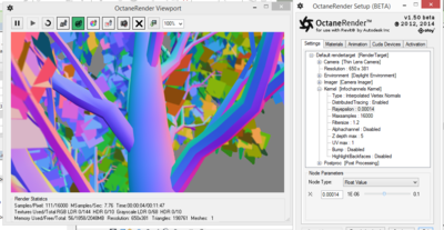

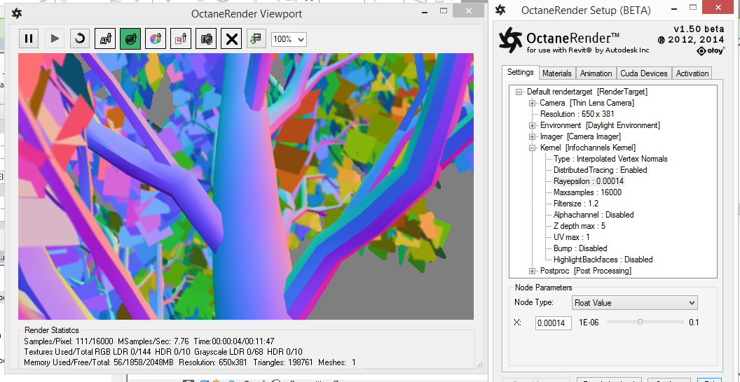

Strange artifact on this tree - I opened this obj (Xfrog eu46) into Max and cannot get this artifact there.
This might potentially be a ray epsilon issue (since the prop will be a different scale in Revit than 3ds max). Does adjusting the ray epsilon fix it? If not, can you pls email me the OBJ file.
Paul
Hi Paul,
I cannot send this model by email, this obj have 320MB, with ultra compression around 100MB. The rayE value have no effect on this. The model in question is the Xf EU46_9.obj.

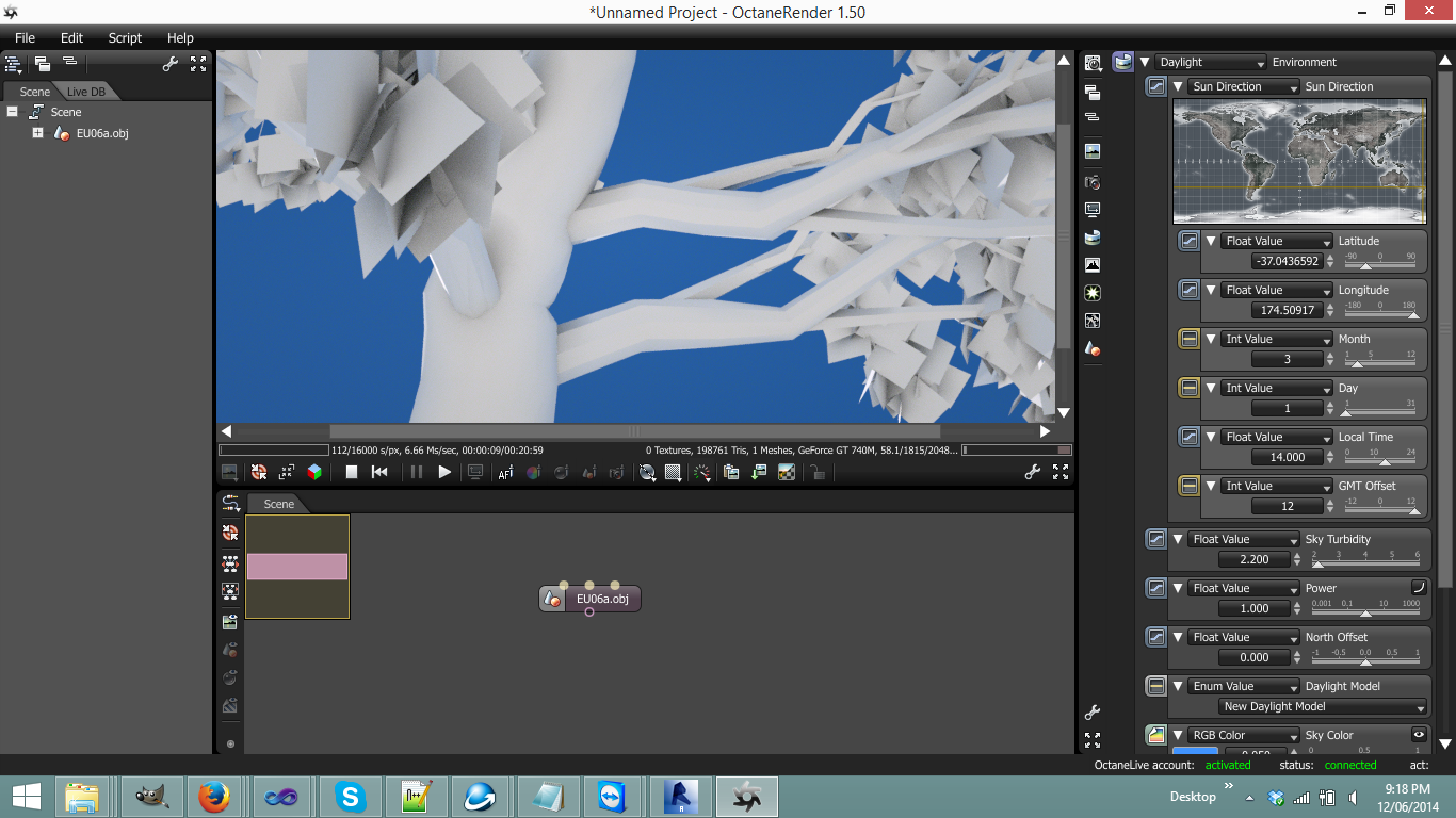

About EdgesRounding feature - I cannot get any results from Xfrog models. This example below, EU06a.obj, with edgesrounding applied to branches:
Without the scene, I'm not sure how I can help you. I cannot reproduce the problem with the OBJ file I use for testing.

I found that the artifact only shows when zooming the render viewport - under normal camera use I cannot see it. The edgesrounding I still cannot get to use.

Pls see http://render.otoy.com/manuals/Revit/?page_id=536 regarding "edges rounding". Edge rounding DOES actually work on welded surfaces such as concave or convex objects, where the surface is not split into 2. So your tree branch /may/ work with rounded edges - but that shouldn't be needed. If the OBJ proxy has valid normals, AND "Smooth" is enabled for the materials of the tree branch, Octane will smooth the surface. Again - if you can email me the tree OBJ I can investigate further.
Paul
face_off
Posts: 15829
Location: Adelaide, Australia
I found the model! You can see the normals for that branch are not smoothed in the OBJ file. So it is a problem in the Xfrog model.

And loading the model into Standalone shows the same wrong normals on that branch.
Paul
