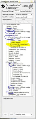

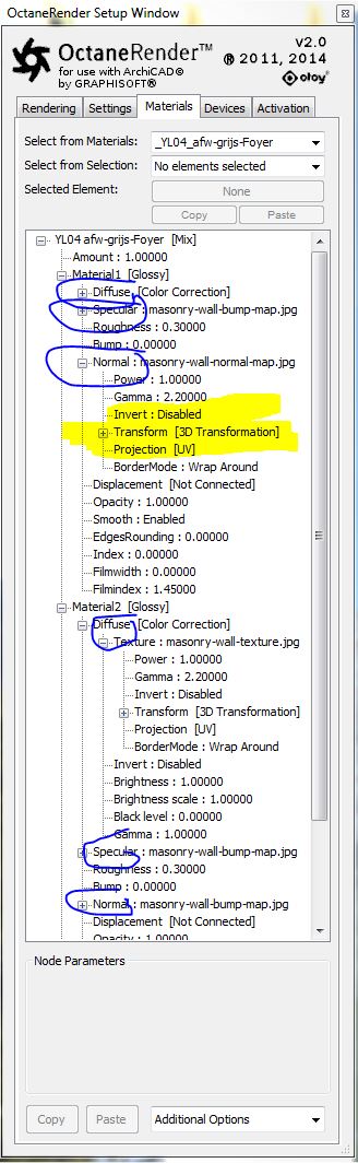

hi Paul,
If I want to scale my material, I have to manually adjust the Transform node for specular, bumb and so on.
Change texture scale in one command instead of many wouldbe great. Is that possible?
greetz, Jeroen
4090+3089ti & Quad 1080ti
http://www.tapperworks.com
face_off
Posts: 15830
Location: Adelaide, Australia
Hi Jeroen - this has been requested previously, and I've done some preliminary work on it, but it is not straightforward, but can be done. So yes, it is planned for the future.
Paul
