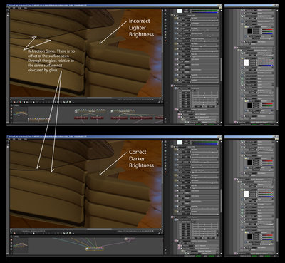

OK...The problem is not as easy as the above would suggest. In my initial test, I found that the recommendations SEEMED to solve the problem. But when I let it render longer, the problem was still there, just not nearly as bad. Finally, although switching Fake Shadows and Alpha Shadows on seemed to increase the amount of light passing through the specular material, I found that the problem had less to do with that, than with the PMC settings. See attached. By dropping Exploration Strength and Direct Light Importance way down, this had the greatest affect on the problem. Yes, turning Fake Shadows/Alpha Shadows on dramatically lightened up what was underneath the glass, but the rounded edges became more natural looking due to the PMC changes.
BUT, what happened to refraction?! I think this is a totally unrelated problem. If you look closely at either image, there is no offset image of the underlying surfaces seen through the glass. It is as if IOR is set to "1". In both images, the Index is set to 1.45, plenty to create the expected offset. Look along the glass edge and there is no refraction bending at all. I don't think this is an Octane problem, but I'll be damned if I can figure out what it is. No matter if Fake Shadows/Alpha Shadows is on or not, refraction is zero. Also, I have checked the surface normals and they are fine...pointing away from the glass surface on both sides. What the heck?!
