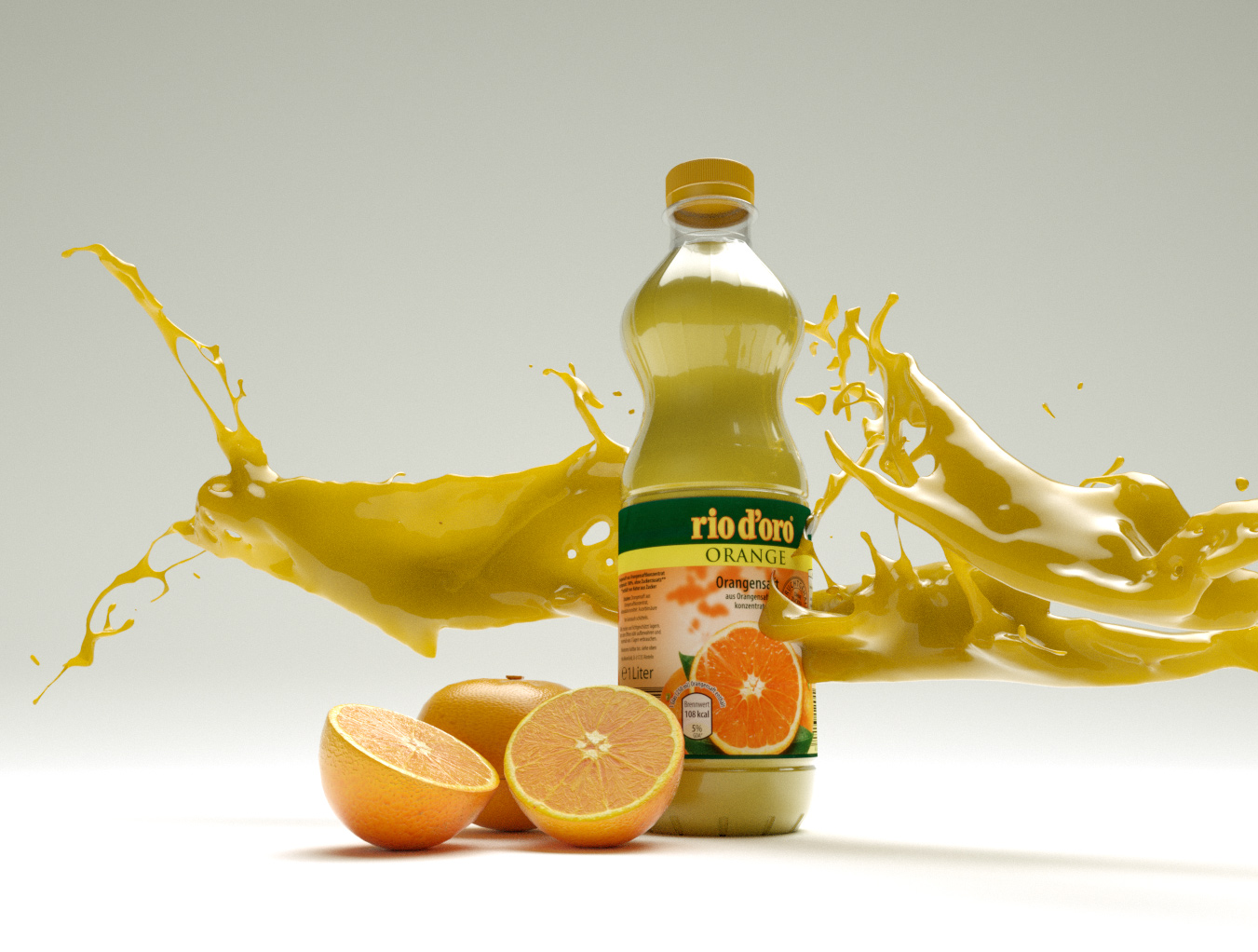

remKa wrote:I think you need to scale the scattering up big time. Give it a value like 1000 or even 2000.
Uhhh - such high values I never guessed to be necessary. Will try that tomorrow. Thanks for the tip.

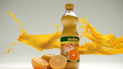

A new try - it's getting closer I think ... does it?
Master: WIN 10 64bit, i7 4930 4,5 Ghz, 64 GB RAM, 1600 W PSU, 1 TB SSD, 14 TB RAID, 2 x RTX 3090

Yep this is way better, but you need pure white reflection now !

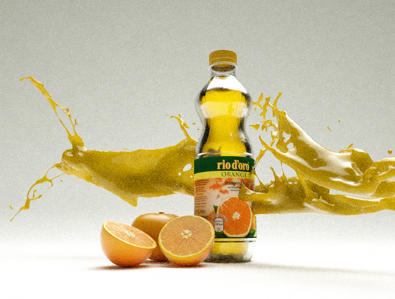

how about this one :mrgreen: :D :mrgreen: :D :mrgreen: :D
you need more ss on the splash 8-)

Ron wrote:A new try - it's getting closer I think ... does it?
Getting close Ron. I just feel you need to lighten the juice (and it's still too green). More transparency might help but also keep tweaking sss. It still looks a bit like paint. Lixai's on the right track over there. Keep going, we'll keep cheering you on...

Looks much better but I think it still looks a bit too thick like soup instead of juice and not orangey enough. Keep going.
Seeker
Thank you for being nice with me :-)
Yes - I will continue trying to find suitable SSS values. Should still be possible.

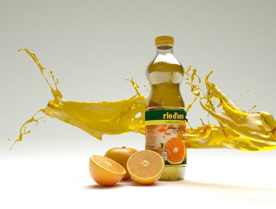

Thank you Angbor3D for your advice. I originaly used the orange juice from LiveDB, but begun changing the medium values and color ...
I tried several of your hints and this is the result:
1: New material for splash with your color settings, absorption and scattering. Liquid inside bottle without abs/scattering.

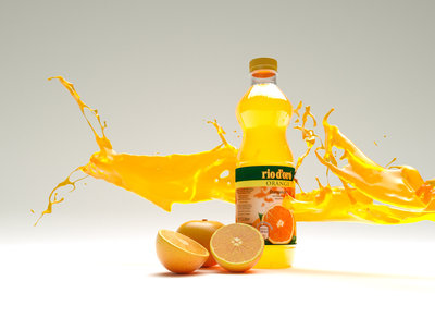

Then I added a bit of emission which gave an interesting result:
Does this look like orange juice?
Looking forward to feedback.
