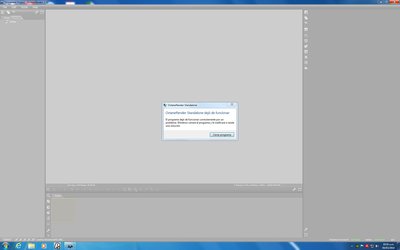

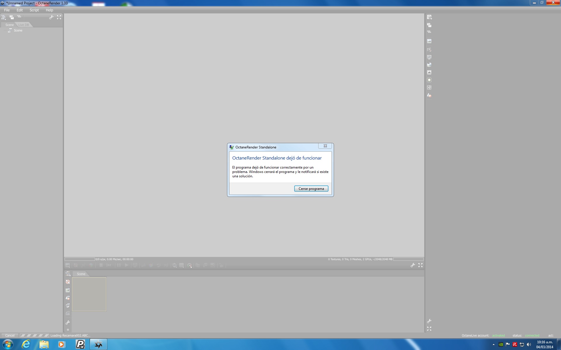

hi abstrax i can't open scene .obj or alembic in the versions 1.33, 1.34 and 1.35, is the same result, error, i add image

merid888 wrote:hi abstrax i can't open scene .obj or alembic in the versions 1.33, 1.34 and 1.35, is the same result, error, i add image
Can you send us an object file which Octane can't load?

sure, let me zip the file

Octane is missing some error handlers to handle unreadable files and the Alembic file seems to be missing some parts. Which application did you use to export this file?
