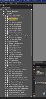

I do not want to duplicate thread but it's probably a good place to suggest a minor improvement.
Please add a feature sort of materials in view of Selection Pane. With dozens of materials such lack of sorting is very cumbersome. Every time you browse through the entire list.
Sorting would be very easier to work with materials. Especially that first level-Scene is sorted. What's going on?
Once again, please consider my request. After all, it must be a moment to change that :)
Unless there is some reason why the sorting of materials can not be made​​?
no sort :)
no sort :)

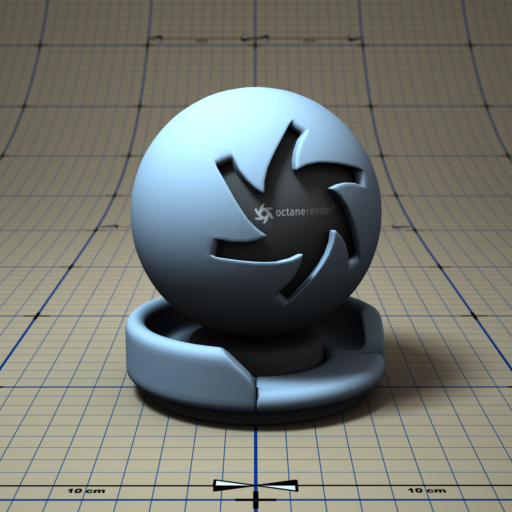

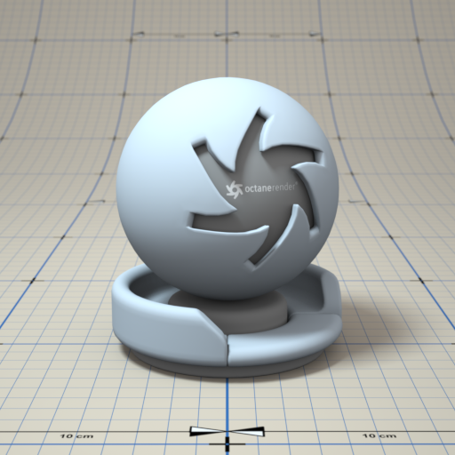

funk wrote: You have misunderstood. I'm not talking about a gamma difference. I'm talking about a difference in exposure (brightness)
In 1.20 the camera imager controls were not taken into account (exposure/fstop etc) but since 1.30 a new method is used and all these controls affect the saved EXR.
eg. In 1.20 I could use the following camera imager settings:
exposure = 1
fstop = 1
iso = 55
gamma = 2.2
response = LINEAR (no camera response)
The brightness of the output of the tonemapped and untonemapped (once gamma corrected) would match. In other words, photoshop would look just like what I see in octane.
In 1.34 this is no longer the case. I need to adjust the EXPOSURE (not gamma!) of the untonemapped EXR in photoshop by -1.35
I have attached a file showing this is not a gamma problem. You can see the first image from octane, the second is the untonemapped EXR (as shown by default in PS), the third is the EXR with a 1.0 gamma. The second image should look exactly like the first.
Ok, now i understand.
I don´t know, but i think it can´t be a match between tone/untone with a gamma other then 1.0.
In one case, the gamma affects the color and dynamic of the image and in the other case, only the color information.
Remember, that the untonemapped image is an hdr image which has dynamic/intensity. And it is untouched from imager settings like gamma and saturation.
The tonemapped one is only a 32bit image which has only more nuances between values than an 8/16 bit image.

face wrote: I don´t know, but i think it can´t be a match between tone/untone with a gamma other then 1.0.
This is incorrect. I could already get them to match in 1.20 with the settings I listed in my previous post.
I can also make them match in PS with a simple exposure adjustment.
My complaint is that the saved EXRs should match the image we see in octane without extra adjustments in photoshop

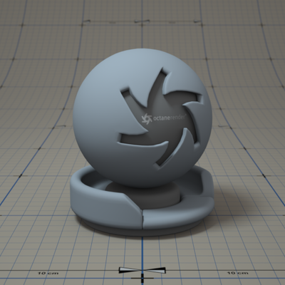

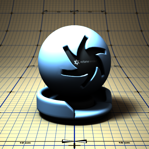

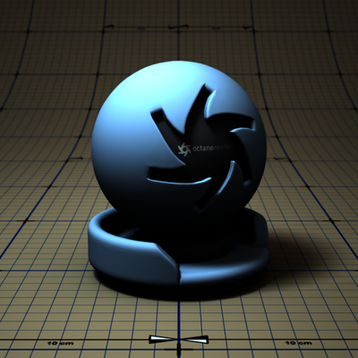

I edited my previous post and added the a third option: We could remove the white point correction alltogether from tonemapped images. This is how it would look like (note how the image gets darker for gamma < 1 and brighter for gamma > 1):
Gamma 0.5 - no white point correction:
Gamma 1.0 - no white point correction:
Gamma 2.2 - no white point correction:
For comparison, this is the current behaviour, applying a white point correction for tonemapped images:
Gamma 0.5 - with white point correction:
Gamma 1.0 - with white point correction:
Gamma 2.2 - with white point correction:
