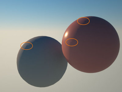

Hi Jimstar,
I installed this version, and I am not sure if it is specific to this release, but I seem to have surfaces problems with a simple sphere. I tried to add more subdivisions but I still get the same issue. It seems that the surface (normals) are not reflecting smooth, even if the smooth is ticked in the shader. I'm really not sure, but the problem seems to be exclusive to the environment light (sun/sky and texture).

Yup, I've seen the same thing.RickToxik wrote:Hi Jimstar,
