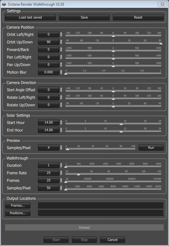

i have a little issue with the "Orbit Up/Down", at max-down the camera reach the 90° and then go back fore some frames.

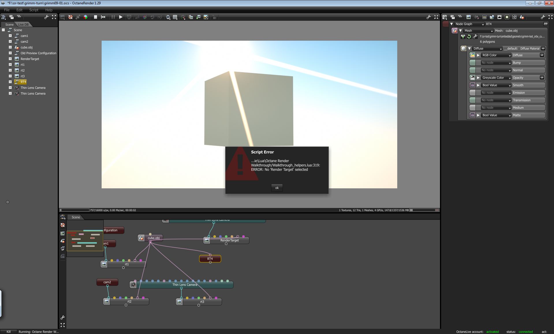

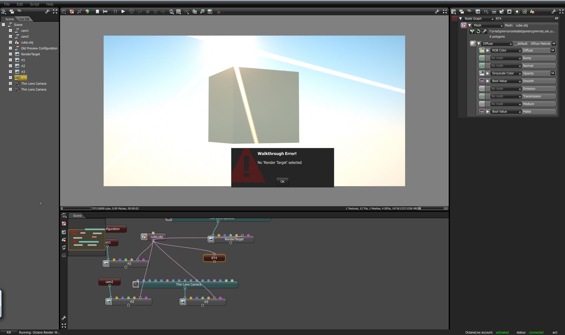

you have the same issue as grimm with an error when a nested rt is selected:
If I am understanding you, you seem to be saying that the orbit Up/Down slider actually is moving through an angle greater than 90 degrees. I cannot reproduce this, can you explain it in more detail?

I had used grimms code as a basis for this application as it provided a fabulous head start, so if his script has some issues, i'm not surprised this script has the some of the same ones. It seems your render target is a macro and I can't tell if it has all the right components, i.e. an environment and a camera node.
Could that be the issue?

try with this simple scene, it's an orbx file, import it and ungroup:
grimm-test3.rar
(5.32 KiB) Downloaded 464 times
i have tried with rt3 and this settings but it jump back a bit at the end:
only rt3 and rt5 doesn't give errors, in the newest version, grimm has solved the issue:
http://render.otoy.com/forum/viewtopic. ... 00#p169647

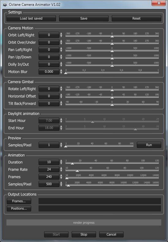

Edit : I did some renaming and shuffling for my own benefit, a pic of which I leave you for consideration.
Its a pity Octane doesn't allow orbit up/down past 90 deg. (why Otoy guys?) because I wanted to do a barrel roll and you cant. :(

Since the camera in Octane can't be more than '90' degrees over the target, once that condition is reached, the animation reverses itself (i'm guessing this is a feature of the :setanimator function on a camera.) Your seeing this issue whenever you are looking up, i.e. the camera is below the target at the start of the frame sequence.
At some point i can put in a trap to prevent the user from moving the slider more degrees than it would take to get directly below the target.
Its a pity Octane doesn't allow orbit up/down past 90 deg. (why Otoy guys?) because I wanted to do a barrel roll and you cant. :([/quote]
I like some of your ideas and you will see them reflected in my next version.
