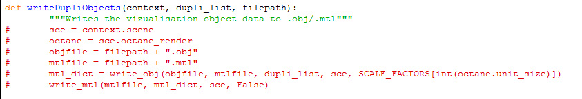

EDIT : I tried with logic and trials and errors, and finally I disabled some lines and the Obj and Mtl are no more exported. However, I don't know if they are internally computed and if some ressource is wasted in the process. I have to test with a big Mesh as instance.
Below the modified script and a screen shot of the disabled lines in the script. Please could you tell me if I did it correctly ?

@Steveps3 : today, I have installed Blender 2.70 for Octane, and tested the 1.0.9b script : it works in 2.70. I also generated a csv file with an object with huge geometry, and the computing took few seconds, so I think that the obj export is actually disabled. :)
For the switch, I don't know if some people need/use it. For my own, I prefer to export obj/mtl only with the 2.02 exporter. The current solution is OK for me. So, except if someone really need it, don't bother yourself with the switch.
I just hope that my hack is correct and will not have hidden effets... :roll:

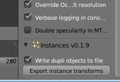

I'm not sure what has happened but I appear to have gotten the export option working again. I've been fiddling with the code for over an hour trying all sorts of things. Eventually I went back to 2.02 exporter and the 1.90 instances, closed Blender, reopened and... it works.
(HW) Intel i7 2600k, 16GB DDR3, MSI 560GTX ti (2GB) x 3
(SW) Octane (1.50) Blender (2.70) (exporter 2.02)
(OS) Windows 7(64)
ROUBAL
Posts: 2199
Location: FRANCE
Did you do it in the official version or Blender for Octane ? I ask, because it always worked and still works in Blender official, but the button is not here in the Blender for Octane version !
steveps3
Posts: 1118
Joined: Sat Aug 21, 2010 4:07 pm
Location: England
Official version.
Why would you want to use the blender4octane version and then export out to Octane? B4O is always going to be behind official Blender so I can't see much point.
I have just tried it in B4O and it works in there as well as long as you turn off the B4O exporter. I think the problem is a conflict between the two blender exporters.
So the steps are
1. turn on blender exporter 2.02
2. turn on instancing
3. turn off oToy Blender script
4. restart blender
bingo

Didn't you forget to enable again the instancing script in your list ? Yes, it works and there is the button (use the 1.0.9a otherwise it will not export the obj and mtl !) But I want to have all my usual Tools enabled. So I will stay with my solution without the button , as I don't need it. For my workflow, it is more efficient to have all my usual Tools at my hand than having the very last Blender version. Anyway my projects are always long and I rarely update blender in the middle of a project and so working on a not very uptodate version is inevitable at a moment or an other.
