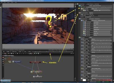

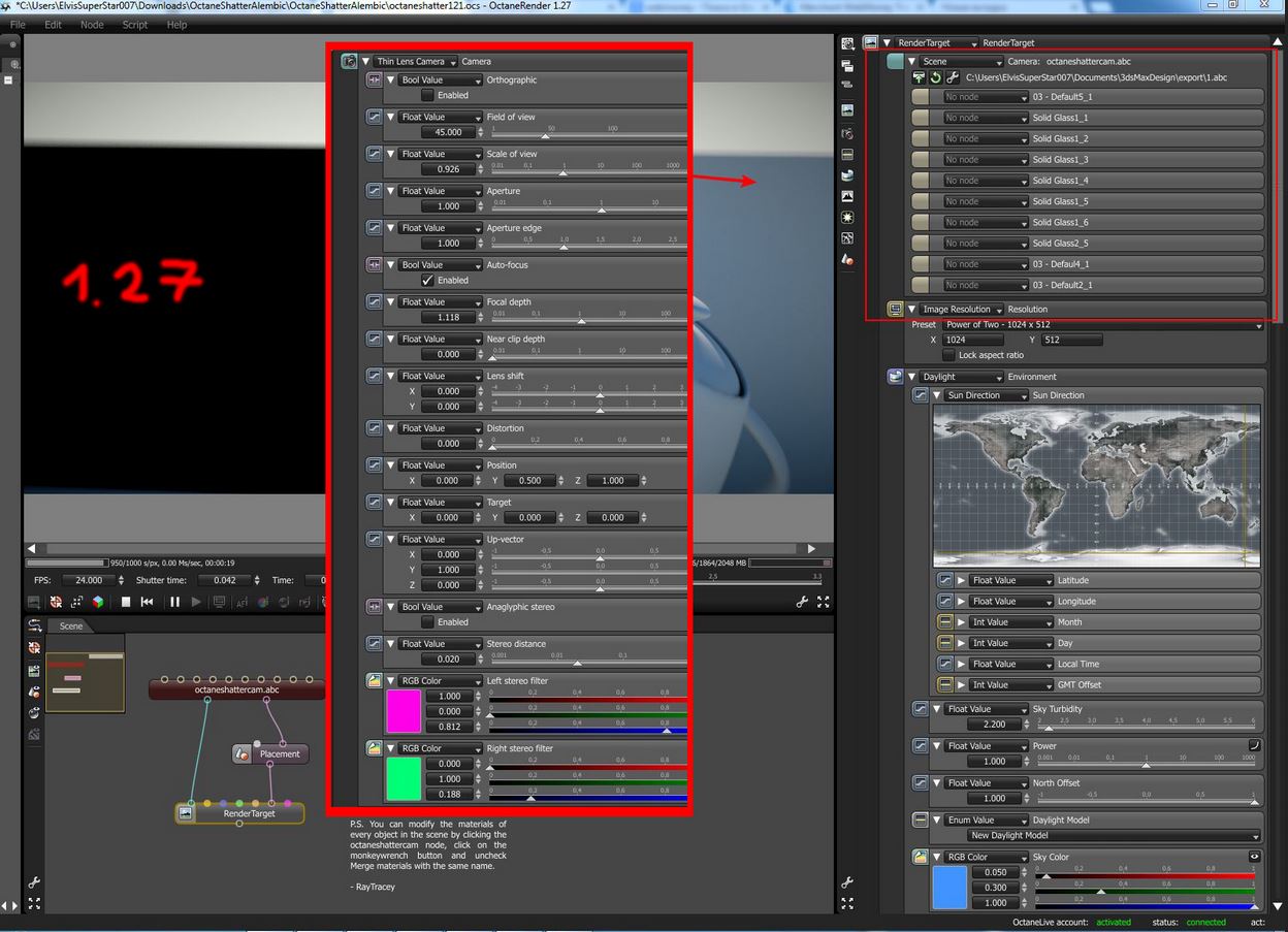

?.. Alembic animationTugpsx wrote:Interesting the Camera shows in my Render TargetElvissuperstar007 wrote:how to set up the camera???
OctaneRender™ Standalone 1.27
- Elvissuperstar007
- Posts: 2620
- Location: Ukraine
- Contact:
I also wanted to ask why we have no access to the camera controls (thin lens camera) in the alembic node.
At first I thought it made sense not to show it since the camera position etc might be animated, but what if I need to adjust a few things which alembic files dont export (eg. aperture edge, near clip depth, anaglyph stereo etc)
Right now I'm importing alembic from modo, and the focal length appears to be wrong in octane. I need the ability to tweak the alembic camera.
Will you be adding this soon?

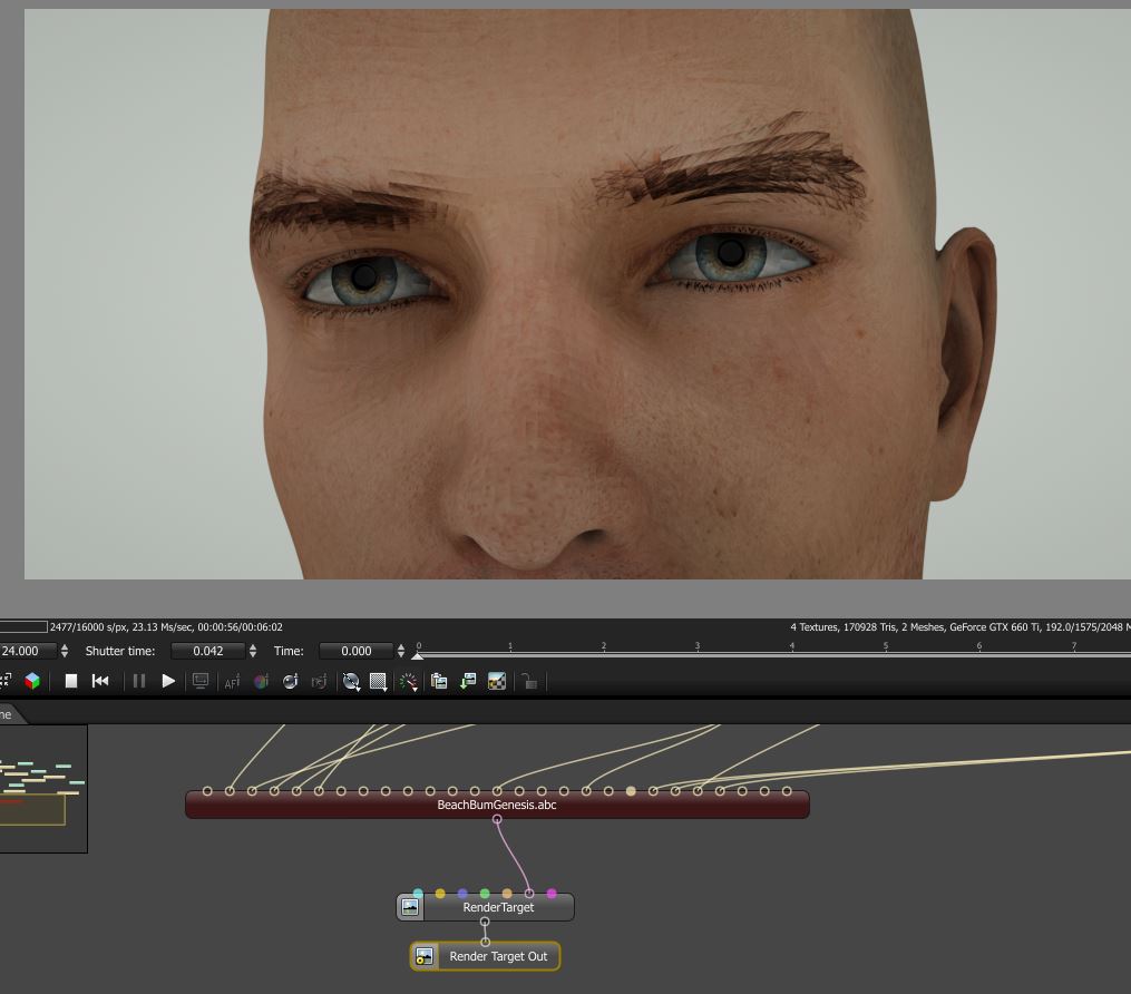

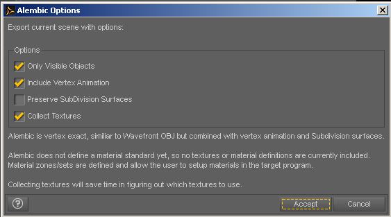

How strange, my exported scene file (from Daz Studio Alembic Exporter) does not seem to show a connector for a camera (as seen in inthe post by Elvissuperstar007)... ?Elvissuperstar007 wrote:how to set up the camera???
There is no Alembic camera slot on the exported 'scene' object file?
Also,
Still have a skin issue with Alembic but not obj?
Any advice please?
Thank you
UPDATE: Trying to import Michael 4 exported by Daz Alembic exporter crashes ORSA EVERY TIME, Genesis exports fine apart from the messed up texture issue! Also, choosing the option 'preserve subdevision surfaces' results in the Alembic export failing to load every time!

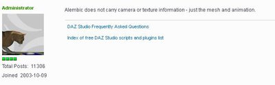

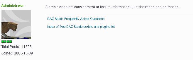

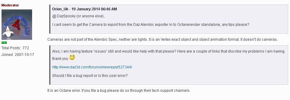

So I guess I am misunderstanding this whole camera thing then people?
Two sources from Daz tell me Cameras are NOT exported with the Daz Alembic exporter or imported with Alembic importers???
I am so confused on this as the videos (Otoy youtube) and some posts here have lead me to believe otherwise!
