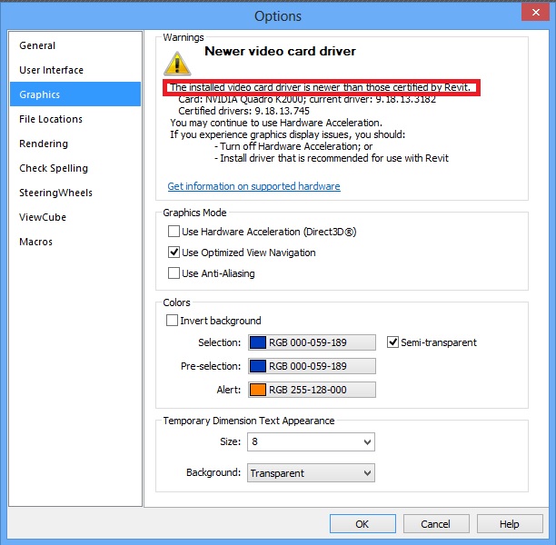

CRASHES:
I got 3 so far, when running the plugin in Revit. Screen flashes black intermittently. Can't control anything. Task manager difficult to access / click on anything once it opens. Had 3 different escapes. a) Had to do hard reboot; b) clicked profusely on the 'end task' button in Task Manager and finally got a hit, which closed both Revit and, of course, the plugin; c) same action as b but this time only the plugin closed and Revit returned to normal. I am not exactly sure what initiated this behaviour but I am fairly certain it was when I was navigating in the Revit viewport (definitely so with the last crash)
I'm pretty sure it could be driver related but the fact that only the plugin closed on one Task Manager closure (of Revit), is a bit strange. I turned off hardware acceleration after b (as described above) but then still got it again as described by c (as per above).
I am a bit pressed for time in the next week or so but will try and install the 'certified' Revit driver (how often does Autodesk update that data I would wonder) and see how it goes.
EDIT: Opened Revit again after the crash (did not restart machine). Everything started ok but then the OVP lost track of the Revit crop window size. Come to think of it, some of the above crashes may have been related to Revit 3D view window adjustments (and also one section box adjustment).
Nvidia driver too NEW for Revit - may be the issue here...(?)

Hendrik - I will work through these issues - but firstly, what Nvidia driver version are you on pls?
Seekerfinder
Posts: 1600
Joined: Tue Jan 04, 2011 11:34 am
face_off wrote:Hendrik - I will work through these issues - but firstly, what Nvidia driver version are you on pls?
331.82 :oops:
face_off
Posts: 15813
Location: Adelaide, Australia
It's tricky to determine what are Octane API issues, what are Nvidia drivers issues, and what are the plugin. In theory in the .NET environment it should be impossible to crash Revit. Nvidia driver 331 is known to have some issues with Octane. 227 is better. The was also some issues in Octane 1.25 which might have caused this is passed an invalid vector (like 0, 0, 0). Octane 1.28 is out, so I will do a build with it so see if it stablises your crashes. The "Nvidia driver too NEW for Revit - may be the issue here...(?)" looks suspect too - so certainly worth getting the last know good version for Revit.
