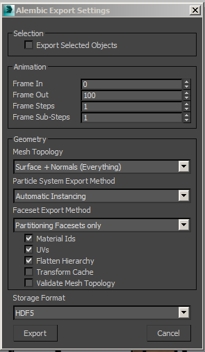

roeland wrote:The time line only pops up when a file containing an animation is loaded.
aptoverde wrote:but now in octane 1.22 gives an error loading the alembic file
Are there any error messages in the log?
We can have a look at some alembic files from various 3D applications to see how materials are exported.
Roeland
I have the same error.
if export goes with such settings as on the attached picture, octane reports an error:
"UV list size mismatch
Parsing of mesh failed: /Line67/Line67Shape
error reading Alembic mesh from C:\OctaneRender_1_22_win64\alembic_test.abc:/Line67/Line67Shape"
in octane 1.21 this error doesn't exist
if the remove checkbox UVs, in octane geometry imported normally, but with the wrong scale.
