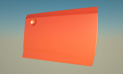

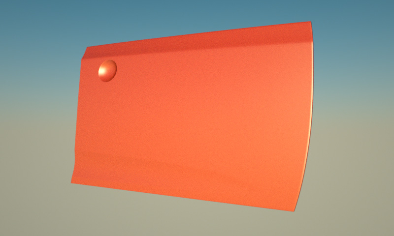

@harshcg:
Two words: scale issues. *sigh*
Try exporting your model with the modified version of bazuka's script I have attached. It's just a quick hack, it wasn't properly tested, animation would probably fail, I take no responsibility whatsoever, yadda yadda yadda; but it gets me pretty pictures, like the one below.

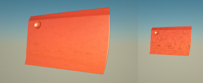

eyearmy: thanks and your right! scale was the problem!
but now that I installed the new script...I am not able to render with exact camera that I have in Maya. for some reason the car is scaled too big, even though I select the right camera while exporting. Is this a known issue with edited script?
Other option I tried is scaling down the whole scene, which fixes the facet issue. But this is not what I want. As i have my scene animated with cameras, and scaling will not really work with everything
Any suggestions?
Any suggestions?

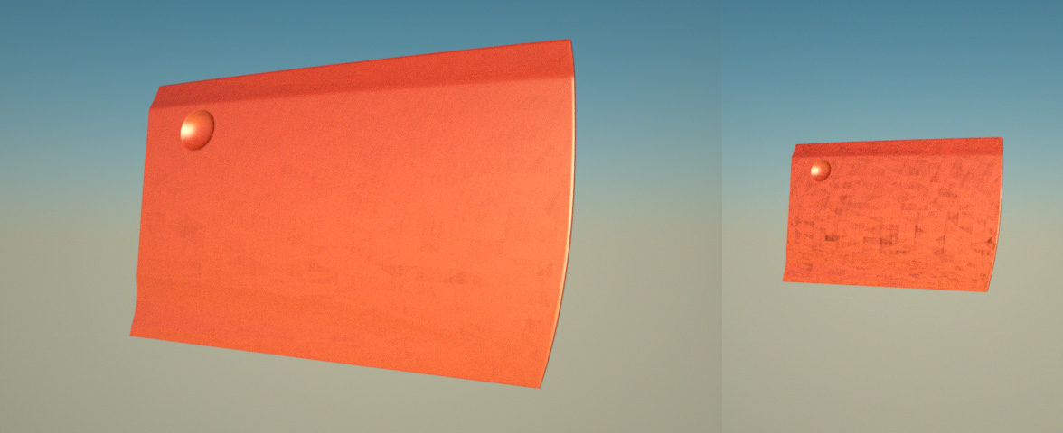

set in metres with the new script or old script?
New script is giving me all sorts of scaling issues. whole scale is scaled up.
In my opinion scale should be NOT included in the script, what we export from maya should exactly how it should look in Octane. Or else what's the point of camera setups in maya.
And when i choose METER in Octane exporter, the whole scene scales again! and when I zoom out it still is not fixing the FACETS.
(this is with the modified script)
Its only fixed by your suggestion of 'rayepsilon' value but not with .0005, instead when I turn it all the way to right .1000 value! What is this for? Does it screw up something else in the scene while its fixing the facet issue?
